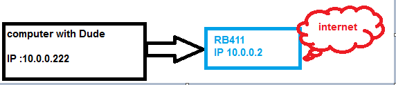

this is how my system built -

From the diagram it seems that your Dude server needs to connect to the internet to send the email and it connects to the internet through the router (which is down when the email is being generated). That will not work as there is no path for the email to travel to the internet. Need to send an SMS using an out-of-band method such as a dial-up modem or mobile phone.

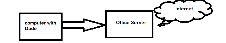

O.k so now I have a computer with the Dude that goes to my office server
and when I config the dude to sent mail
in the setting I define my own mail - david@myoffice.com
and in the send to the same - david@myoffice.com
I get TimeOut

on the general tab of the settings of the server configuration there is a Primary SMTP server, put the ip address of your mail server there and then in the from field put dude@work.com. On the polling tab click next to notification, click the 3 dot button, double click notification, click test. Under advanced make sure there is a check next to down-up and unstable-down.
