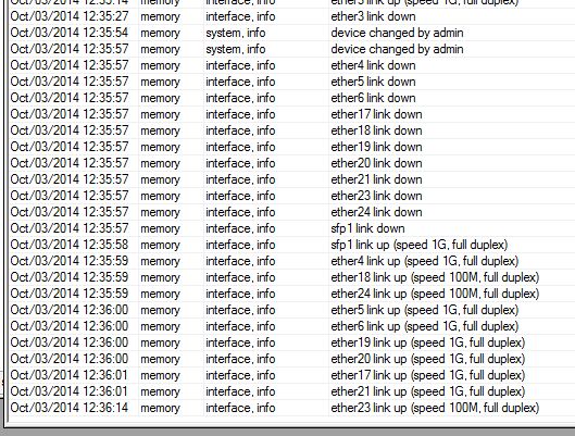

If master port changed state (connect/disconnect), all slaves do redetection.
