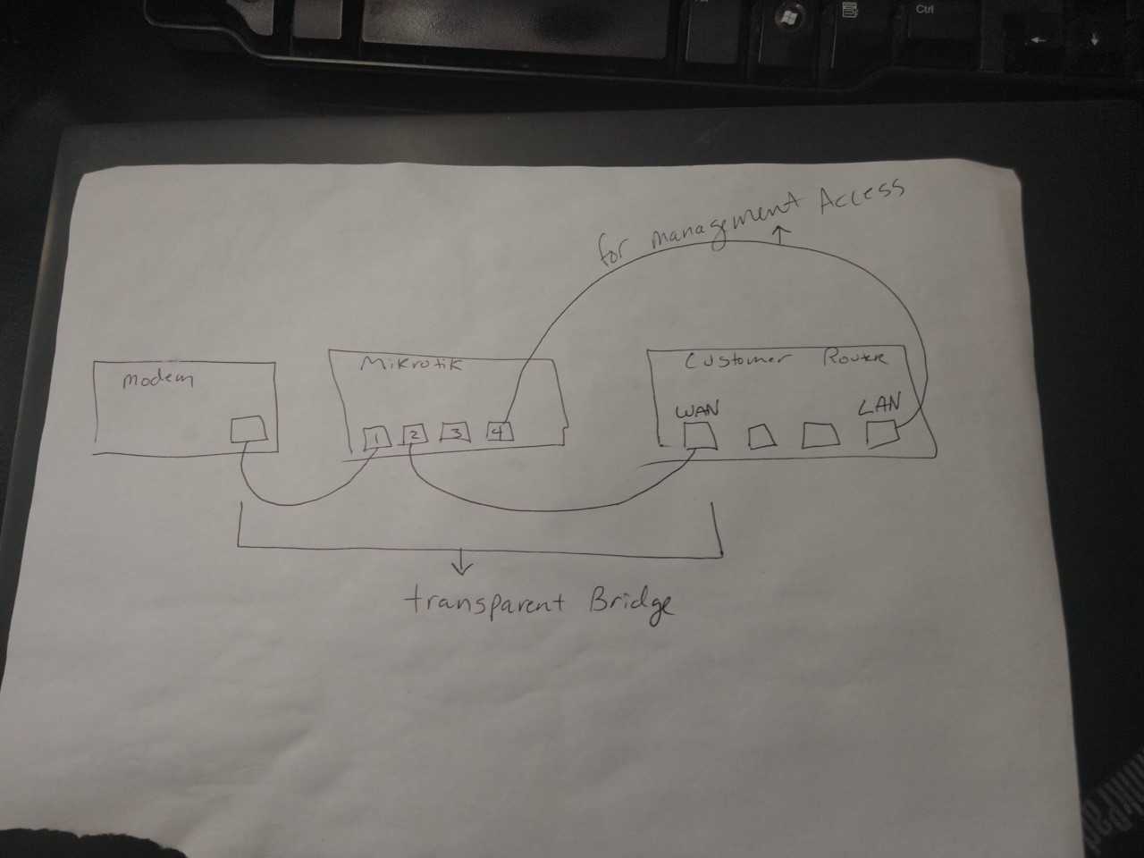

I need a device (Mikrotik) between the ISP and the customers router that can transparently auto detect the ISP connection type then perform an action based on the result.
If it detects PPPOE then do something
If it detects Dynamic then do something
If it detects Static then do something
This needs to be Layer 2 detection, it needs it to be transparent, it will be between the ISP equipment and the customer router.
ISP Connection --------> Transparent Mikrotik Layer 2 Bridge that can detect connection type ----------> Customer router that will handle the WAN (PPPOE, Dynamic, or Static)
I would also like this device, connected to the customers LAN for easy management/Internet access. Attached is a diagram of how it should all be connected.
Any ideas how I can achieve this?
