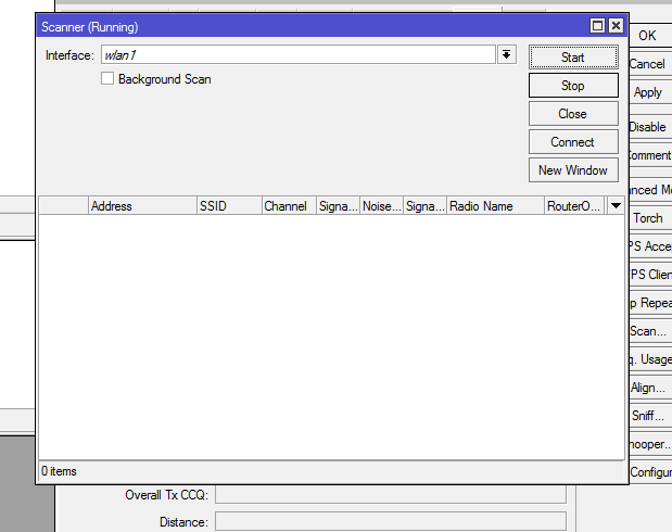

I added screenshot to explain better what i meant.

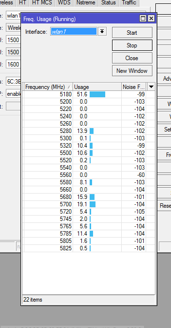

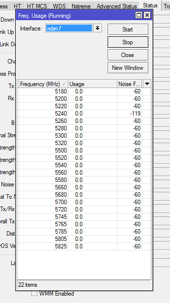

This is the SXT at my site, I ran scan and freq. usage tools.

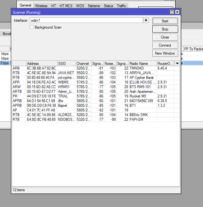

And this the SXT AP, when I ran scan and freq. tools. You will see this one can see other SSIDs around the premise.

Have you done a reset configuration on the SXT, then a wireless scan? If it produces the same results then I would do a net install of a bug fix only release and try it from there. If nothing changes I would suggest doing an RMA on the device.
Yes, i did reset config on it, by pressing the black button near the ethernet port. Still nothing came up on wireless scan tool result. I haven’t done netinstall however. I’ll try it and report back. but i’m a bit skeptical.
Okay, I did netinstall and the symptom is still the same, wireless scan doesn’t show anything. Is my SXT consider a goner now?

Looks like the wireless card died,
The sxt qlite5 will work you just need to set the band to 5Ghz only N and not AC
Yeah looks like it. I did netinstall a few times. And the other day i was getting some ssid popped up when i scan the wireless. But it wont connect. After a reboot, it was back to nothing again.
