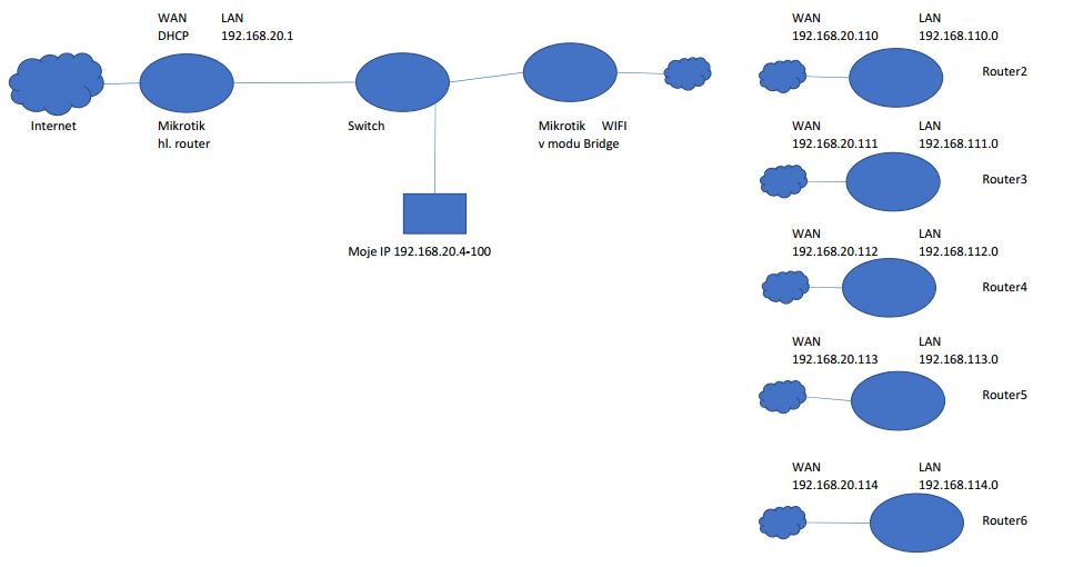

Since I am not very wrought in this one, do I need someone to write an example of how to do it on Mikrotik AP in bridge mode? basically I just need the range IP 192.168.20.110-114 not to reach 192.168.20.4-100 but vice versa from the whole range 192.168.20.0/24 to IP 192.168.20.110-114 range yes.

This Wifi is only for those 5 clients and they do not know SSIDs or their wifi passwords, I add them to myself, they do it if they scanned the network to not find my printers, satellites, etc. from my range 192.168.20.4-100, otherwise I do not mind.

These are simple routers and blocking is not going well. Better it would be on my MikroTik, which is also Wifi AP and is in bridge mode, but I do not know how to isolate the network range 192.168.20.4-100 just for these 5 routers 110-114, no extra secure locks I do not need.

Because I just need what I have already written - clients need to get to the range 192.168.20.1-3 for some reason. I do not want to isolate from network 192.168.20.0 just the extent as I already wrote. Then I would have to work hard to put more rules on the main router to get my services on the internal network that are at 20.1-3 addresses.
