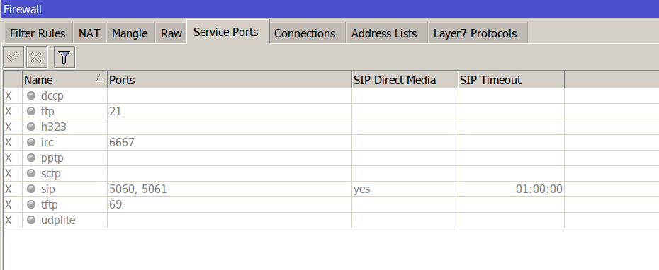

I also became interested. And I decided to turn it off.
Config:
Where is the mistake?
Attempts to disable one at a time or all at once - the result is the same.
There is no mistake: can’t be disabled.
When “red” are not active (I = Invalid)
You can not visually disable that on any way

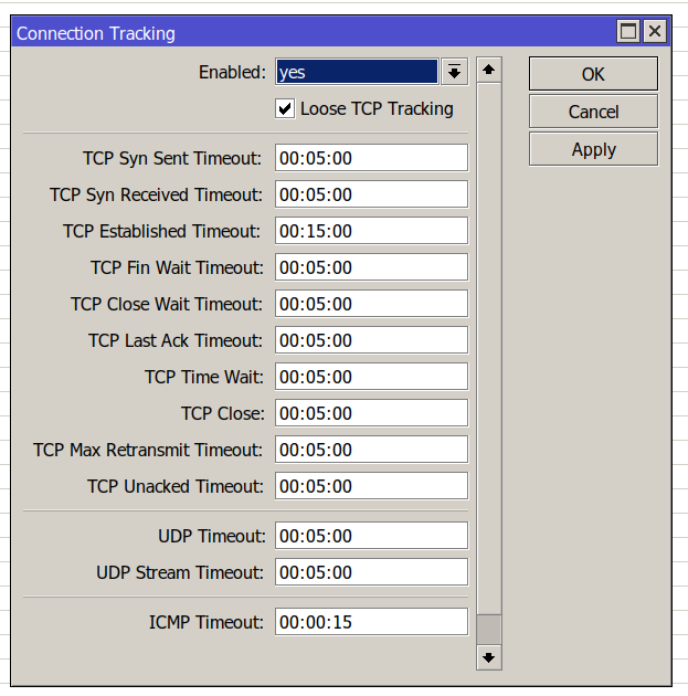

But when conntrack is (forced)off, the 3 items are red because are not active (I = Invalid).
On my RB5009 / 7.3.1 all of them are disabled (already a long time) and Connection Tracking for sure is active!
Is only visual
try to “disable” and enable it again…
In a nutshell, to see them “deactivated” visually, install or downgrade to 7.0.9,
then deactivate them,
then upgrade to 7.4,
but you can no longer reset the machine, as you do they “reactivate”.
But internally on 7.1+, visaully disabled or not, still active.
