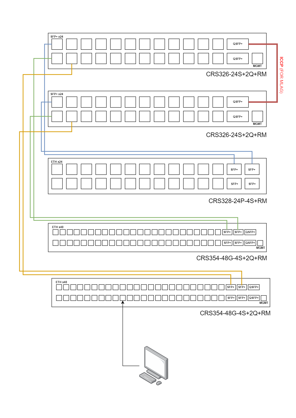

The schema is a little more complex from the question that I posted, so it looks like this
The first two switches are my top of rack in an MLAG configuration, the other three switches are essentialy for the LAN of the office(servers, workstations, ip phones etc). What I want is to manage all switches from any eth port present in the diagram.
For the moment the only solution I found is to connect the management port of each switch into the third switch and add an IP to the bridge of the third switch. It works but I have to sacrifice a lot of ports for this setup.
One important thing is that the setup is more complex then this, cause the TOR configuration is not just for the LAN that I described above, but there are multiple VLANs for differente kind of traffic, like proxmox ceph, proxmox cluster, and other stuffs.
So essentialy in this diagram the TOR ports are all in the same bridge VLAN with id 300, and all other swithces have a bond vlan interface with id 300 in the same bridge with all the other ports

As I wrote in the First post, If I put my PC in any port of the switches I can manage through winbox all the switches but I have to insert the IP manually, what I want is to Discovery the devices through neighbors list.
