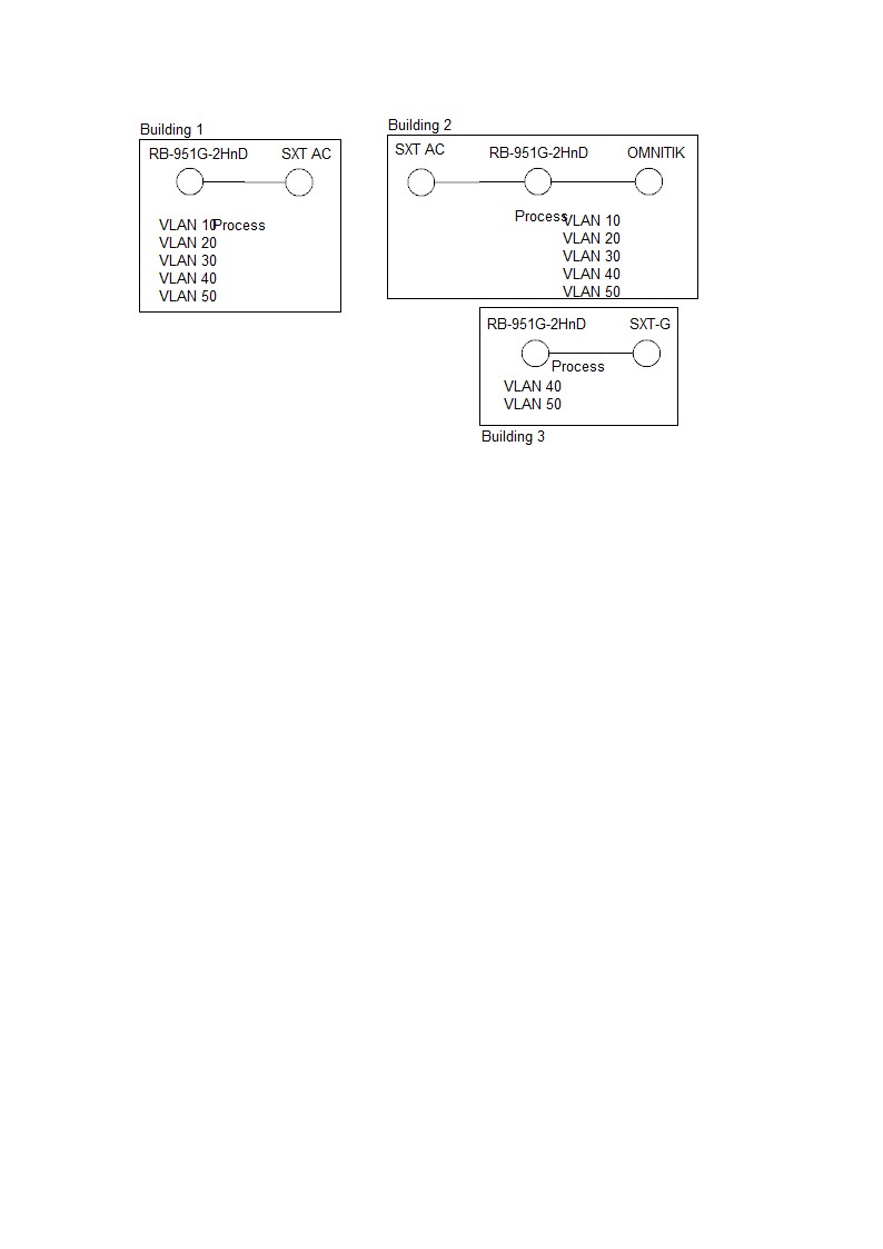

How to do this?
I would like to build a network.
With three buildings as you can see on the picture.
On building 1 there are 2 Mikrotik devices. The RB-951 is allso the DHCP server for each VLAN.
The[/img] SXT-AC must connect to bulding 2 SXT-AC.
On building 2 there is an OMNITIK to connect to building 3 SXT-G.
Building 2 and Building 3 must allso use the DHCP server on Building 1.
How t oconfigure eacht device?

Building 1 and Building 2 are connected with bridge and station bridge.
Please help me with the VLANs

RB951 building 1:
create a bridge interface for each vlan
add IP addresses to the bridge interfaces and configure respective DHCP server instances
create VLAN sub-interfaces on the interface towards the SXTAC
add the subinterfaces as ports to their respective bridges
configure a trunk port with vlan subinterfaces to connect a LAN switch for building 1 or configure access ports on the RB951
if needed, set up masquerade for the vlan subnets to the WAN interface, if there is a WAN on this router
RB951 B2:
create VLAN sub-interfaces on the interface towards the SXTG
configure a trunk port with vlan subinterfaces to connect a LAN switch for building 2 or configure access ports on the RB951
RB951 B3:
configure a trunk port with vlan subinterfaces to connect a LAN switch for building 3 or configure access ports on the RB951
SXTAC B1 & B2, SXTG B2 & B3
setup the radios to connect, I assume you know how to do it
set the MTU on ether and WLAN interfaces higher than 1500, for example 2000, this is to enable switching packets with the vlan tag
