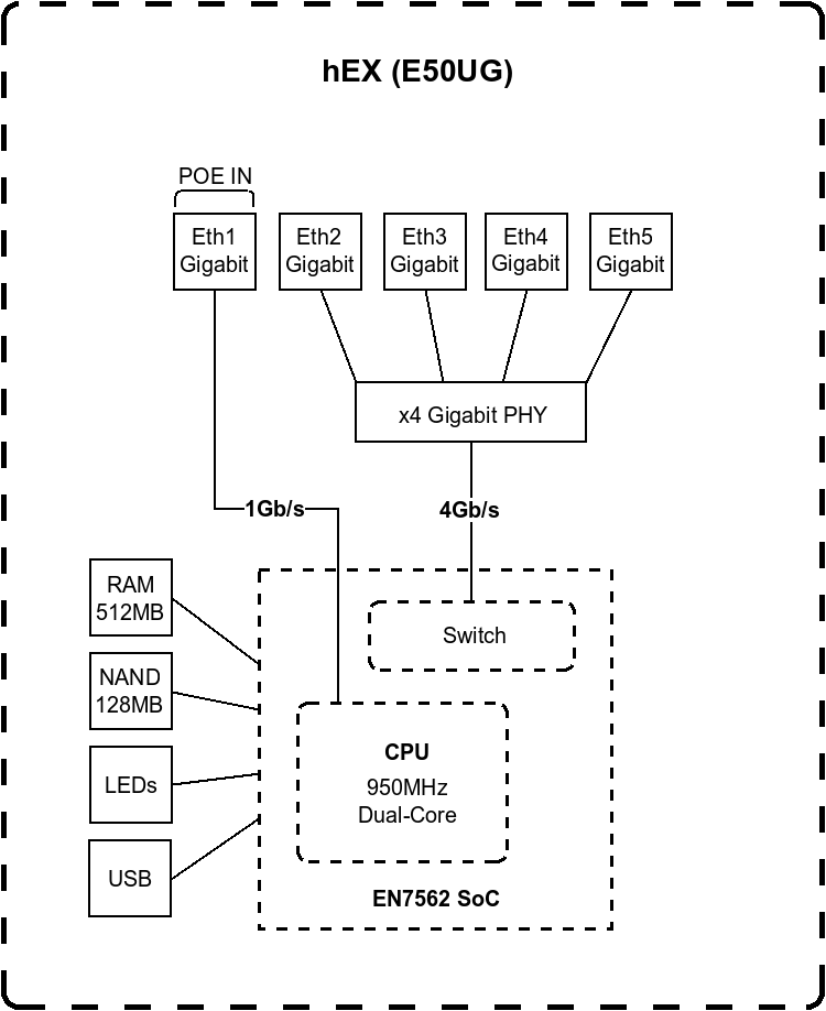

New to MT. Just got a Hex Refresh,
The Refresh got an internal switch MT7621 capable of VLAN decoding. https://help.mikrotik.com/docs/spaces/ROS/pages/15302988/Switch+Chip+Features
I have a setup where I configured port 1 to WAN and Port 2 as LAN with 2 sub vlan, BASE and GUEST.
set [ find default-name=ether2 ] name=LAN
/interface vlan
add interface=LAN name=BASE vlan-id=19
add interface=LAN name=GUEST vlan-id=15
With this setup, am I using the MT7621 for VLAN decoding ? Do I need to create a bridge to use the MT7621 for hardware decoding ?
Just follow one bridge setup and you’ll be fine.
Vlan attached to bridge.
ROS will take care of hw offloading in background.

If you only require the VLANs on a single port the configuration arrangement is fine as-is.
The hardware offloading on the smaller Mikrotiks is only L2 / ethernet switching for packets between bridge ports within the same VLAN, any traffic between different VLANs or between a VLAN and the WAN is always handled by the CPU.
