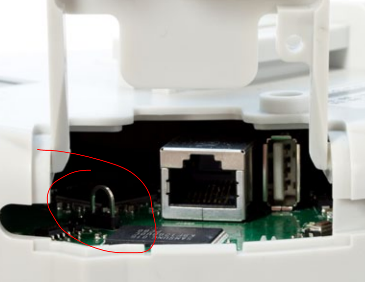

to the left of the ethernet, is a grounding connector (metallic loop).
connect grounding wire there. for the groove, you can only use the shielded cable and ground at the bottom of the tower (at the next device).
Ok, I suspected that strange ring to be the ground. How to connect a cable to that? Only I can think of is solding which is not my thing, specially in such close space.

Hmm. Is there a certain way how the grounding is supposed to be attached to this loop?
I’d really prefer not to solder as it is kind of hard standing on a tower or roof.

Hi, I’d also like to know what is the proper way of connecting a grounding wire to the metallic loop jumper. Solder?

As for the old style loop I just put an alligator clip on the end of the ground wire and called it good. Always dab some silicone on it if you’re worried about it slipping off.
New ones use screws and are much better.
-Mac
Alligator clip sounds like a good idea, why haven’t I thought of it? :smiley: Thx
