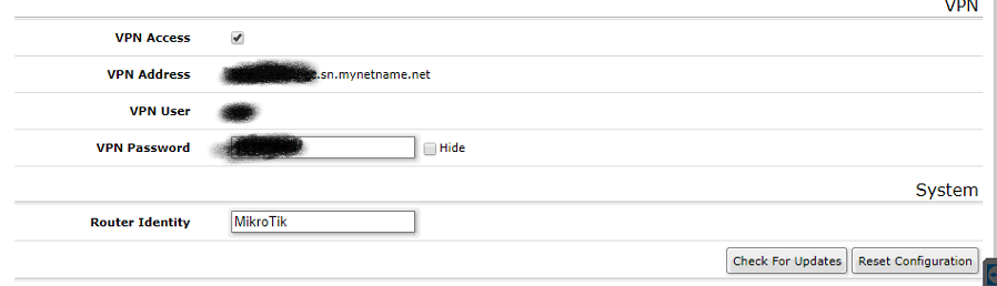

OK. So i decide not to access webfig through internet, but I can’t enable the winbox access too.
I enabled the ip/cloud services from Quickset (see the attached screenshot) and I can access any service port from that address.
So I know that the cloud service works.

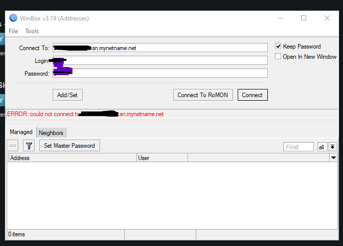

But still unable to access the RB from winbox from outside (internet)
Can someone tell me what I need to do ?

so if you enabled VPN access in there, you can connect from a remote location with L2TP/IPsec VPN tunnel, with the credentials you provided
unfortunately I can’t :frowning:
I try to change the username/password, disable/enable the cloud service, nothing works so far
If you use VPN, then you shouldn’t be connecting to xxx.sn.mynetname.net in WinBox, that address is only for VPN client. In WinBox you should use whatever private address the server uses in tunnel (I don’t know what Quick Set configures), after you connect to VPN.
