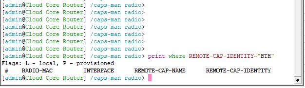

Thank you for the quick response.
It did not work either.
As you can see no results…but print shows all the AP’s

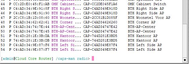

Hope this helps.
