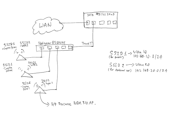

Hi All,
Have been stuck on this issue for quite awhile now, unable to find any resources to help with this implementation.
Basically I am using a Mikrotik 951UI as my AP/“Controller”
I want to have 2 different SSIDs, on 2 different vlans, and using a switch and 3 MSM310 Accesspoints, broadcast the 2 SSIDs throughout the site.
Is it even possible to do this?
