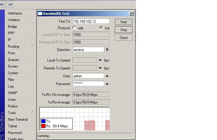

I just did some test for you guys to see how good ROS rc 13 is. Ping time 1 to 3 ms ,link 14.8 KM.
Looks fair.
If you can do six or seven hops and still stay under 25ms your network should run VoIP great!!
That’s about the standard we try and work to.
