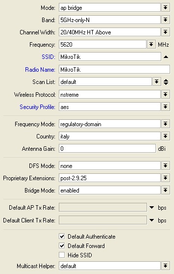

Currently I'm using nstreme because using NV2 i can get about 5-10Mbps more throughtput but latency is not as good as nstreme and because of this the global throughput of the network is worse with nv2 than nstreme.
I'm getting a really good signal and CCQ so I can't explain why I can't get 300Mbps/300Mbps radio link.

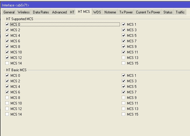

I blocked it to MCS 12 (180Mbps) both on client and AP to get a more stable throughput.
If i set it on MCS 13 and better or to default i get a lower average throughput because it keeps switching between data link rate.
It isn't always 180Mbps/180Mbps: it keeps switching. Sometimes it's also 90Mbps TX or worse.
Nstreme settings are:
Polling enabled
Framer policy: dynamic size
Framer Limit: 3000
If i increase the framer limit i get a worse throughput.

Signal

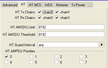

HT MCS
HT
Advanced

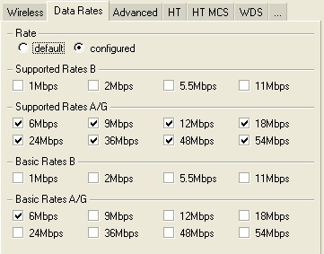

Data Rates
Wireless
