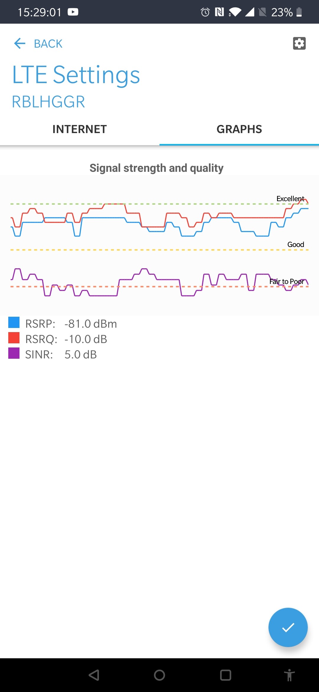

I’m new to all this & trying to set up a LHG series CAT6 LTE outdoor wireless router LHGG LTE6 kit.
I have line of sight 2 miles to a VF mast but when I try to connect I’m only getting a maximum of
Download 10 Mb/s
Upload 20 Mb/s
RSPR of -81db
RSRQ of -10db
SINR of 5db
When I move the aerial the SINR increases when the RSPR & RSRQ decrease. Is this normal?
I’ve a 15m Cat6 ethernet cable which is routed beside the electrical fuse box, would this make any difference?
Any suggestions welcomed.

In general if RSRP is better then SNR should/can be better too.

Yes but bad SINR can be caused from other parameters too, such as interference…
