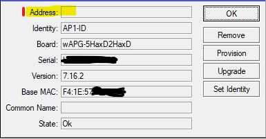

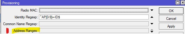

how to get "Address" in CAPSMAN?
I would like to provision my cAPs via the Address (I assume IP-Address?).
But the Address-Field is empty and therefore any provisioning-rule does not match.
How can I get the cAPs IP to the CAPSMAN?
In the documentaion it is not stated:
ip-address-ranges (IpAddressRange[,IpAddressRanges] max 100x; Default: “”)
Match CAPs with IPs within configured address range.

You are probably trying to use Wireless CAPsMAN with cAP AX that only supports newer Wifi CAPsMAN. Try to post more info and you configs.
First check if both ends are using the same driver - Wifi or Wireless.
I just tested this: you have probably set “discovery-interface=” in your CAP config. This means your CAP connects via Layer2 to Capsman.
To filter via IP-Address, the CAP has to connect via Layer3 to Capsman. For this, you either set the IP-Address of CapsMan in the CAP config or send the capsman ip-address from your DHCP server (IP → DHCP → Networks → add the CAPS Manager IP-Address to your Network).
