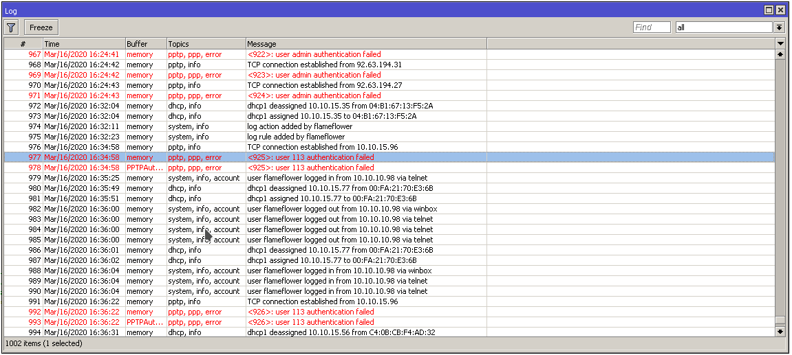

For L2TP connections it works fine, but it didn’t work for PPTP because in <> brackets we have some number instead IP.
Any ideas how to get SRC IP from failed PPTP authentication parsing log files?
Did you find any solution?
The IP is in the previous log line “TCP connection established from …”
