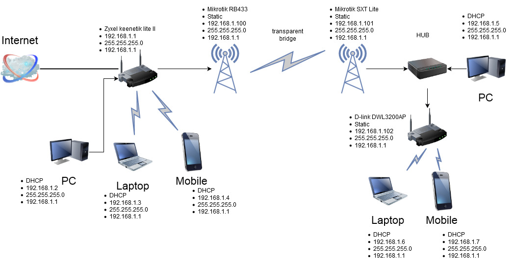

There is a network
a network bridge is created by points, the point is 192.168.1.100 3 interfaces, eth1 cable, wlan1 is the radio channel, bridge1 – bridge between eth1 and wlan1. And the same scheme in the second point 192.168.1.100.101. Each interface has its own MAC address. The bridge0 interface is selected as the main interfaces of the points creating the bridge. Addresses of points are static.

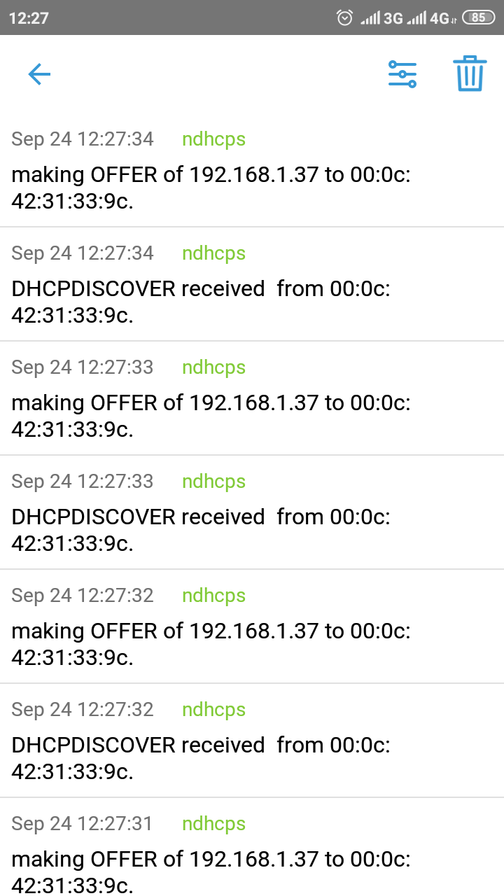

The problem is that the Central router 192.168.1.1 somehow inexplicably finds MAC addresses of other interfaces (eth1 and wlan1) persistently tries to issue them IP addresses, but at it is impossible since the pool of addresses outside addresses of the bridge, but it does it very often, several times a second that very strongly loads the processor:
WDS on the bridge is enabled in dynamic bridge mode.
ARP tried to include and disable for all interfaces in a row and differently-there is no effect.
You will not prompt that it is possible to make with them that dhcp did not go mad?
Can the points forming the bridge to clean in other subnet or to create for them VLAN?

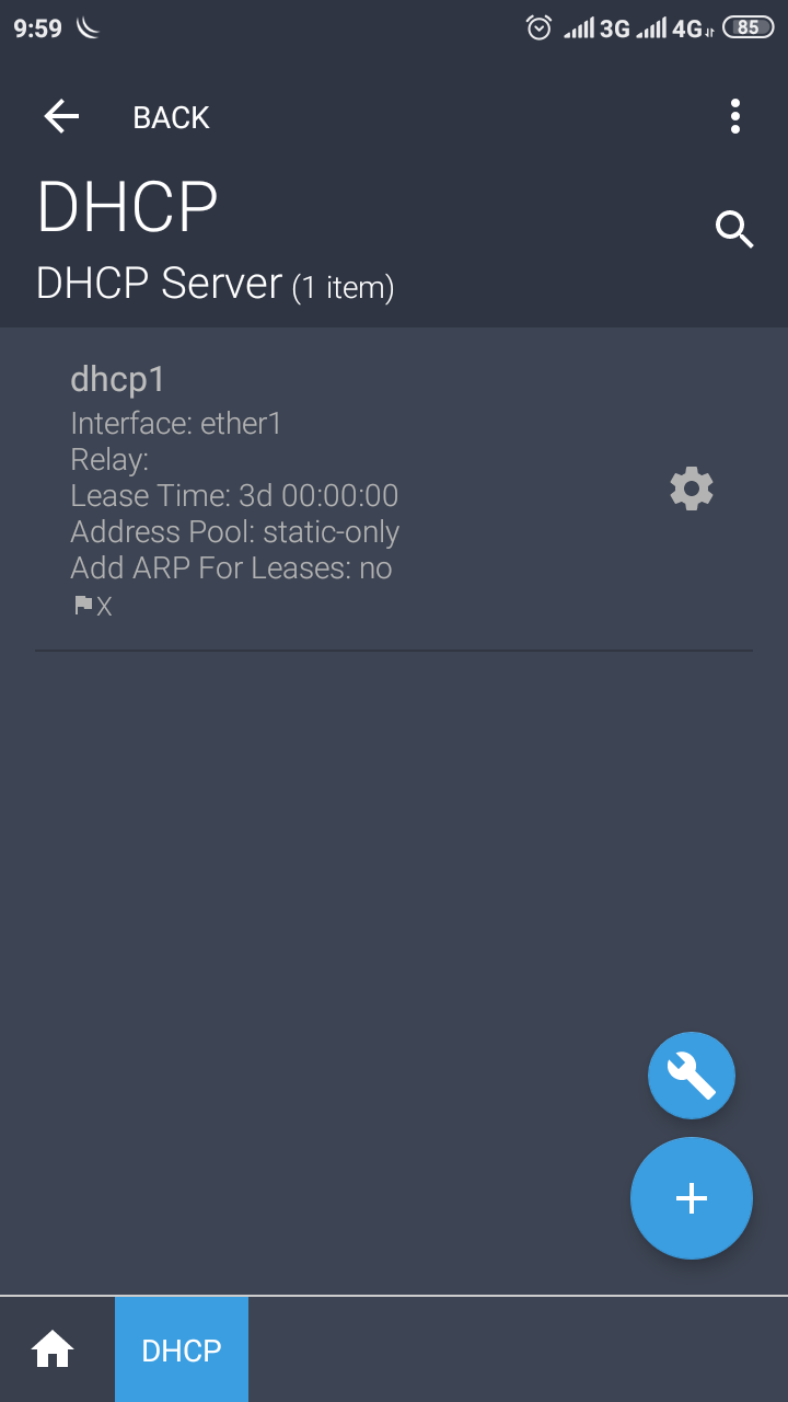

Both DHCP client and DHCP server and DHCP relay are disabled, marked with the x flag.

What about this?
add authoritative=after-2sec-delay interface=ether1 lease-time=3d name=dhcp1
he is not running.
