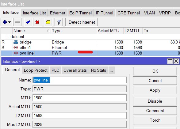

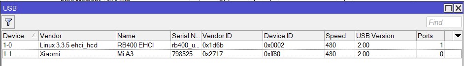

Short small check on USB smartphone connection.
  1. Connecting mAP Lite (Micro-A connector) to a laptop gives no software pop-up nor any USB device in the Windows Device management
    → Probably the USB Powerline adaptor is some OTG cable, to make the mAP Lite react. (Just guessing). Now the mAP Lite is just powered.
  2. Connecting the smartphone to a “hAP ac Lite” with a large type A USB connector, and setting the smartphone on “USB tethering” brings the smartphone in the USB device list, but there is no interface connected with that USB device (like the predefined PWRLine ethernet interface in the mAP Lite for the USB connector)
As explained before, this works with the laptop. Windows creates an extra network interface.
I’m stuck. No idea how to get further with this …
