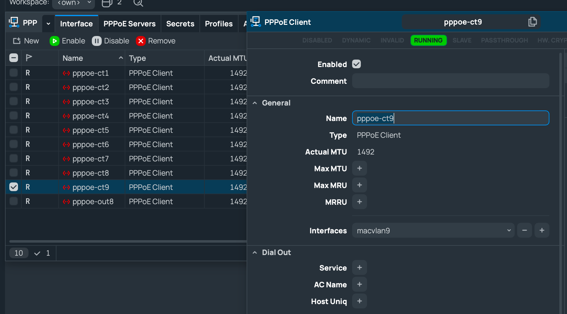

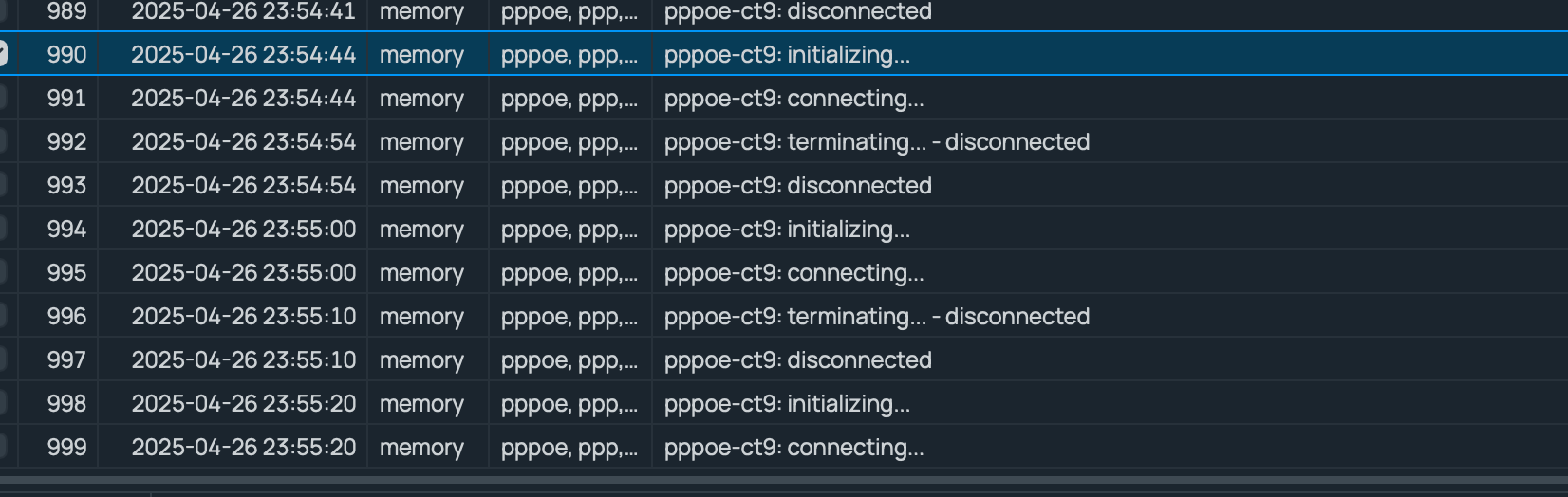

My ISP allows me to dial multiple times using the same account and password, but each dial-up must have a different MAC address. Additionally, my ISP’s server will limit the number of dial-ups within a short period based on my account, so I need to wait for a while before continuing to dial.
However, I discovered today that even if I disable all PPPoE interfaces and then enable all PPPoE interfaces simultaneously, although the logs keep showing dial-up failures, after waiting for 11 minutes, the dial-ups will gradually resume successfully.
The reason I post this topic is that I want to re-enable the PPPoE interfaces with a determined time delay instead of letting it constantly attempt redials in the background. Continuous retries might trigger the ISP’s restrictions.
Below is my current configuration.

yes, view my upload image.
What happens if you establish more than one connection?
I need to use a different public IP as an outlet for my service.
What causes sessions drops so frequently that you need reconnect again and again?
My ISP may disconnect at 48 hour intervals and let me re-establish the connection.

If the connection cannot be established, the remote PPPoE server will time out, and even using PPPoE Scan, the server cannot be detected. It is necessary to wait for 10 minutes before the server will respond to my requests again.
I think the server has protection measures in place to prevent users from making a large number of dial-out attempts in a short period of time.
