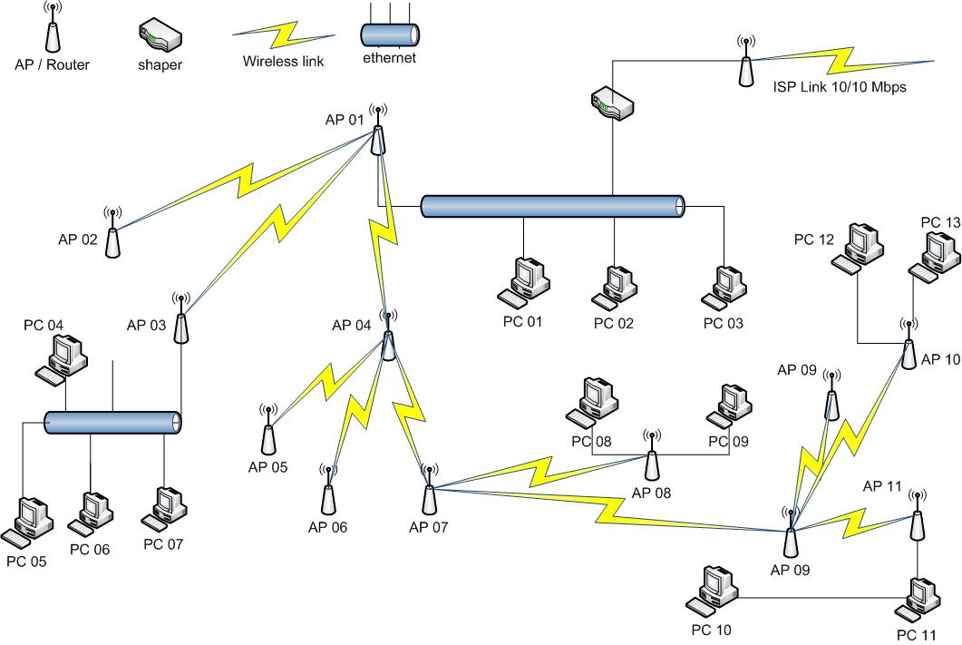

It is very hard to solve what bandwidth shaping method is the best!
I think all methods are usefull…
Look at my model what I have created for this thread :wink:
We could try to find best way…
You have 10/10Mbps from your ISP and you want to share it equally to all of your customers. Consider that you have 500 customers.
My consultant told me, that I should give to all of my AP quaranted bandwitch to shape all my clients on each AP. If I want to give quaranted BW to each AP (for example 3Mbps per AP) I have to buy 33Mbps from my ISP!!!
The question is “How to share 10/10Mbps to all of my customers” !!!
Example:
I want to give to each of my clients 1/1Mbps.
I want to have max trafic 4Mbps on each AP at once!
Solution:
I do not know…
What will happend If I shape all of my clinets on main shaper?
How to share shaper´s load to another shaper??
It is better centralized od decentralized shaping?
I do not realy know…
