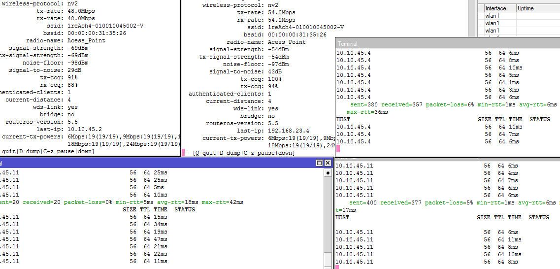

Hi all, I have 2 CPE connect to the same AP.
but the problem is, how can we make the AP ping to the CPE getting 1 ms as the link is clear LOS and signal is good.
as compare to use the infinet, ubnt and some other’s, the can make the ping time 1ms.
any setting we can use to improve it as our requirement from AP to CPE is <3 ms?
appreciate for the sharing…
I have noticed that the increased ping times come from using nv2. If 1ms delay is important to you try using nstreme.

hi, once change to the nstreme, the latency is very good.
