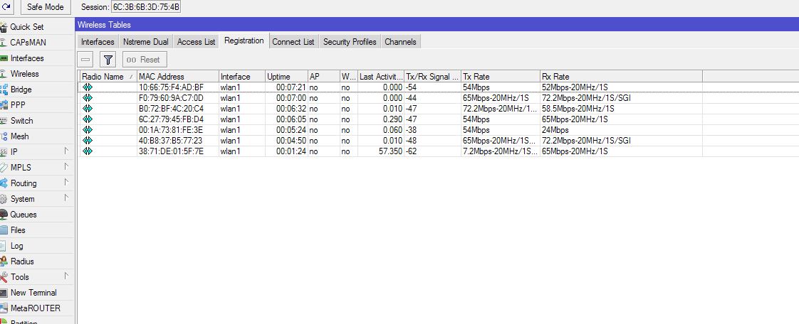

Can you open a New Terminal, and issue
/interface wireless spectral-history range=5ghz 0
and upload a screenshot here?
Now is in testing mode on my laboratory (tryng with Android - Notebook - iOS)
As request
/interface wireless band=2ghz-b/g/n
/interface wireles band=5ghz-a/n

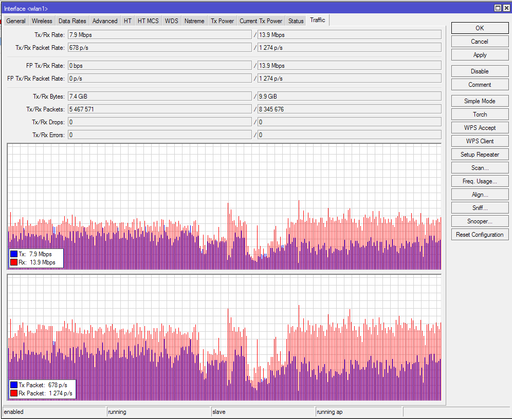

Other Screen… Running 4 btest form desktop
1 udp tx
1 udp rx
1 udp tx rx
1 tcp tx rx
only one client connected
