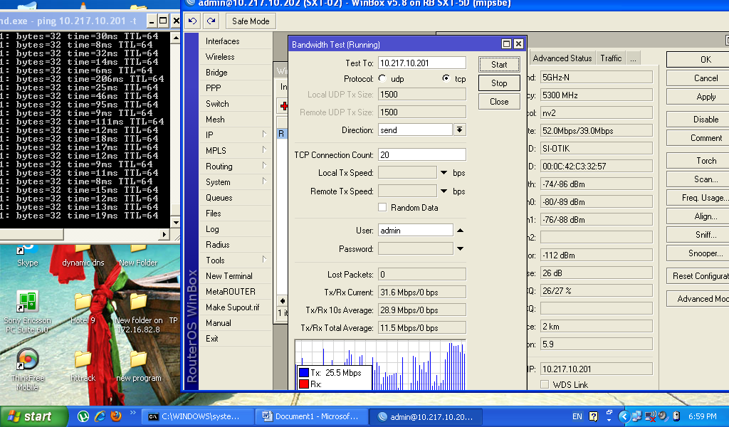

I changed Frequency to 5300Mhz and channel width to 20/40Mhz HT Below, then it is better for latency. but signal still low, around 26 to 30 db and can’t reach my desire.
I tried to survey and increase the pole to 6m + building 10m for subscriber far from BS 2Km. Omnitik is installed on the building with 40m high. And i get the result as picture shown.
Please give me the advise on this.
at 2 km ur tx/rx rate should be better. perhaps it is fresnel hence the speed highs n lows and poor average. i have earler posted my result for 4 km n i get almost 100 mbps. tx/rx connectivity is 240/240.
