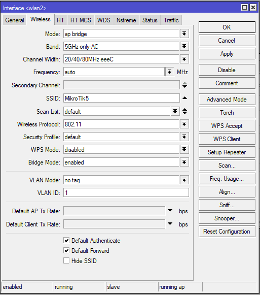

Show us your wireless registration tab
How?
Make a screen shot

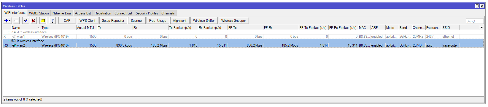

Just make some test with large file transfer. Laptop is Lenovo X220 with Intel Centrino Advanced N-6205 300Mbps adapter and another PC is connected with Ethernet cable. Channel width is 40MHz and adapter is rated 300Mpbs/300Mbps, no other station on 5GHz near me. The speed vary between 185Mbps and 200Mbps as seen from attached screenshot. RouterOS version and firmware is 6.42.10. I don’t have ac adapter to test with, but with n adapter I think results are O.K. Posting your config will be helpful to find out what is wrong.
This is near maximum for n Standart, please make picture from registration tab too
