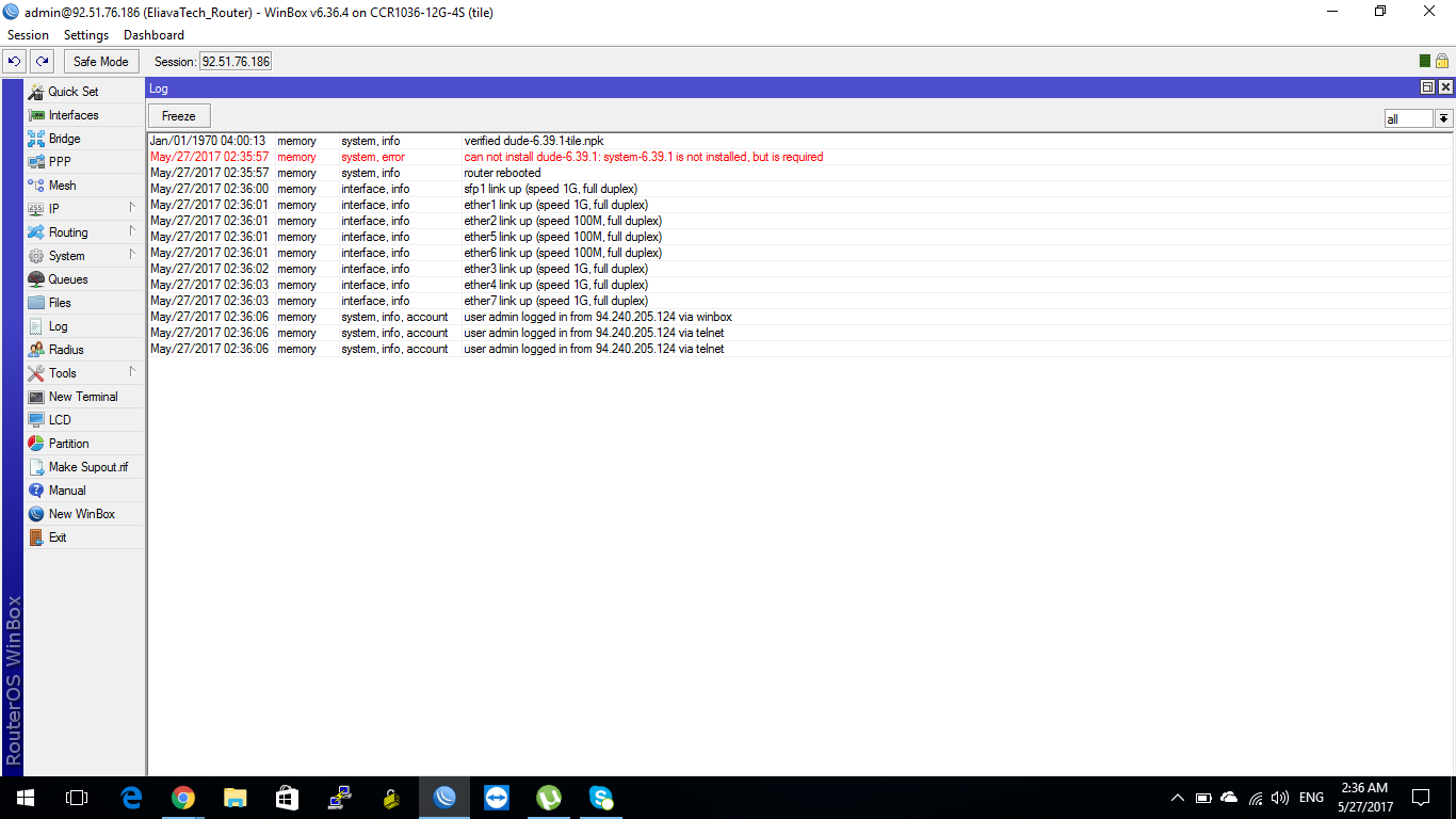

hi guys .. i am new in this site… i have problem whit dude server.. when i whant install dude server on router board CCR1036 (Firmware version 3.33) and rebooting router. dude is not instalating on router… how i can solve this problem … ?
ROS version? did you check the log?
version 3.33
