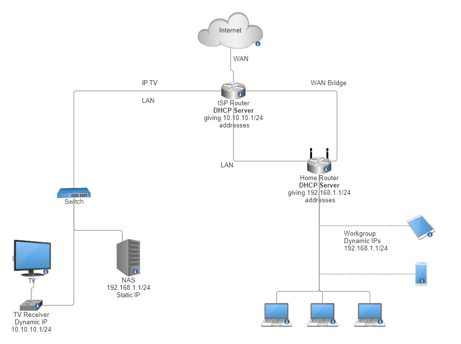

Hi folks,
I’m facing very interesting problem here, I made this weird configuration because I had to hook up my TV and NAS server using only a single cable, and this NAS server should communicate with the workgroup devices. I can of course install additional wire specifically for NAS but I wonder if it can be like this? The problem is that devices in the workgroup segment sometimes getting wrong IP address (from ISP router instead of Mikrotik).
So is there aany way to ISOLATE devices connected to mikrotik and somehow force them not to broadcast DHCP requests beyond Mikfotik router iteslf?
