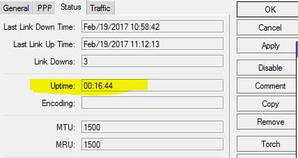

How to know how much time PPP is connected?
using command ?
Hello ,
I want to save into a file the modem uptime
Didn’t find how to save it in a command
I have try
:put [/interface get ppp-out1 ]
:put [/interface ppp-client get ppp-out1]
In both of them I don’t get the option to see the uptime
So how to save it?
Thanks ,
My impression is that Winbox calculates that value based on last-link-up-time vs current time.
