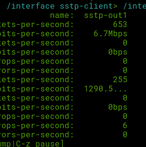

I managed to make this script which I put in scheduler in 1 minute cycles , but it doesn’t work well because it reactivates the vpn as soon as there is no traffic but the vpn didn’t disconnect.
    /interface monitor-traffic sstp-out1 once do={
        :if ($"rx-packets-per-second" = 0 ) do={
                    /interface set sstp-out1 disabled=no ;

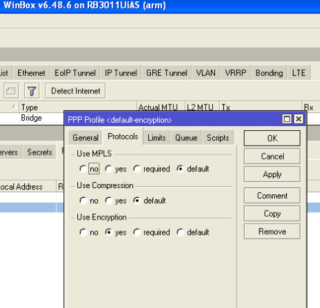

This below is the manual procedure that I followed and that has only the defect of never reactivating …
  :global username "USERNAME"
:global password "PASSWORD"
:global range "10.0.0.108/32"
:global hostname "nl.hide.me"
/interface sstp-client add authentication=mschap2 connect-to=[:put $hostname] disabled=no name="hide.me SSTP" password=[:put $password] profile=default-encryption tls-version=only-1.2 user=[:put $username]
/ip firewall mangle add action=mark-routing chain=prerouting new-routing-mark=SSTP passthrough=yes src-address=[:put $range]
/ip firewall nat add action=masquerade chain=srcnat out-interface="hide.me SSTP"
/ip route add distance=1 gateway="hide.me SSTP" routing-mark=SSTP
:set hostname "";:set password "";:set username "";:set range ""

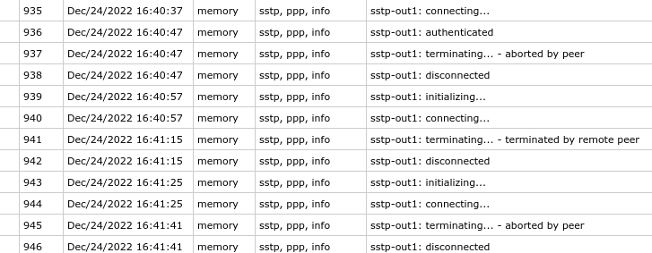

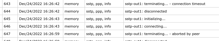

Fair enough. Their config looks okay to me – all defaults other than auth stuff. And the auth stuff pretty sure they’d know what they support :wink:.
But from your logs it does look like it’s trying, just not connecting. If you add a bit more logging, might give us a clue as to why. This will cause debug-level logging of SSTP:
/system logging add topics=sstp,!packet

Dec 26 18:16:49 x.x.x.x logger sstp,ppp,debug sstp-out1: IPCP closed
Dec 26 18:16:49 x.x.x.x logger sstp,ppp,debug sstp-out1: IPV6CP lowerdown
Dec 26 18:16:49 x.x.x.x logger sstp,ppp,debug sstp-out1: IPV6CP down event in starting state
Dec 26 18:16:49 x.x.x.x logger sstp,ppp,debug sstp-out1: MPLSCP lowerdown
Dec 26 18:16:49 x.x.x.x logger sstp,ppp,debug sstp-out1: CCP close
Dec 26 18:16:49 x.x.x.x logger sstp,ppp,debug sstp-out1: BCP close
Dec 26 18:16:49 x.x.x.x logger sstp,ppp,debug sstp-out1: IPV6CP close
Dec 26 18:16:49 x.x.x.x logger sstp,ppp,debug sstp-out1: MPLSCP close
Dec 26 18:16:49 x.x.x.x logger sstp,ppp,info sstp-out1: terminating... - connection timeout
Dec 26 18:16:50 x.x.x.x logger sstp,ppp,debug sstp-out1: LCP lowerdown
Dec 26 18:16:50 x.x.x.x logger sstp,ppp,debug sstp-out1: LCP down event in starting state
Dec 26 18:16:50 x.x.x.x logger sstp,ppp,info sstp-out1: disconnected
Dec 26 18:16:51 x.x.x.x logger sstp,ppp,info sstp-out1: initializing...
Dec 26 18:16:51 x.x.x.x logger sstp,ppp,info sstp-out1: connecting...
Dec 26 18:17:01 x.x.x.x logger sstp,ppp,debug sstp-out1: LCP lowerup
Dec 26 18:17:01 x.x.x.x logger sstp,ppp,debug sstp-out1: LCP open
Dec 26 18:17:02 x.x.x.x logger sstp,ppp,debug sstp-out1: LCP timer
Dec 26 18:17:03 x.x.x.x logger sstp,ppp,debug sstp-out1: LCP timer
Dec 26 18:17:04 x.x.x.x logger sstp,ppp,debug sstp-out1: LCP opened
Dec 26 18:17:04 x.x.x.x logger sstp,ppp,info sstp-out1: authenticated
Dec 26 18:17:04 x.x.x.x logger sstp,ppp,debug sstp-out1: IPCP lowerup
Dec 26 18:17:04 x.x.x.x logger sstp,ppp,debug sstp-out1: IPCP open
Dec 26 18:17:04 x.x.x.x logger sstp,ppp,debug sstp-out1: IPV6CP open
Dec 26 18:17:04 x.x.x.x logger sstp,ppp,debug sstp-out1: MPLSCP lowerup
Dec 26 18:17:04 x.x.x.x logger sstp,ppp,debug sstp-out1: MPLSCP open
Dec 26 18:17:04 x.x.x.x logger sstp,ppp,debug sstp-out1: BCP open
Dec 26 18:17:04 x.x.x.x logger sstp,ppp,debug sstp-out1: CCP lowerup
Dec 26 18:17:04 x.x.x.x logger sstp,ppp,debug sstp-out1: CCP open
Dec 26 18:17:04 x.x.x.x logger sstp,ppp,debug sstp-out1: received unsupported protocol 0x8057
Dec 26 18:17:04 x.x.x.x logger sstp,ppp,debug sstp-out1: IPCP opened
Dec 26 18:17:04 x.x.x.x logger sstp,ppp,info sstp-out1: connected
Dec 26 20:08:22 x.x.x.x logger sstp,ppp,debug sstp-out1: LCP lowerup
Dec 26 20:08:22 x.x.x.x logger sstp,ppp,debug sstp-out1: LCP open
Dec 26 20:08:23 x.x.x.x logger sstp,ppp,debug sstp-out1: LCP timer
Dec 26 20:08:24 x.x.x.x logger sstp,ppp,debug sstp-out1: LCP timer
Dec 26 20:08:25 x.x.x.x logger sstp,ppp,debug sstp-out1: LCP lowerdown
Dec 26 20:08:25 x.x.x.x logger sstp,ppp,debug sstp-out1: CCP close
Dec 26 20:08:25 x.x.x.x logger sstp,ppp,debug sstp-out1: BCP close
Dec 26 20:08:25 x.x.x.x logger sstp,ppp,debug sstp-out1: IPCP close
Dec 26 20:08:25 x.x.x.x logger sstp,ppp,debug sstp-out1: IPV6CP close
Dec 26 20:08:25 x.x.x.x logger sstp,ppp,debug sstp-out1: MPLSCP close
Dec 26 20:08:25 x.x.x.x logger sstp,ppp,info sstp-out1: terminating... - aborted by peer
Dec 26 20:08:25 x.x.x.x logger sstp,ppp,debug sstp-out1: LCP down event in starting state
Dec 26 20:08:25 x.x.x.x logger sstp,ppp,info sstp-out1: disconnected
Dec 26 20:08:31 x.x.x.x logger sstp,ppp,info sstp-out1: initializing...
Dec 26 20:08:31 x.x.x.x logger sstp,ppp,info sstp-out1: connecting...
Dec 26 20:08:47 x.x.x.x logger sstp,ppp,debug sstp-out1: LCP lowerup
Dec 26 20:08:47 x.x.x.x logger sstp,ppp,debug sstp-out1: LCP open
Dec 26 20:08:49 x.x.x.x logger sstp,ppp,debug sstp-out1: LCP timer
Dec 26 20:08:50 x.x.x.x logger sstp,ppp,debug sstp-out1: LCP lowerdown
Dec 26 20:08:50 x.x.x.x logger sstp,ppp,debug sstp-out1: CCP close
Dec 26 20:08:50 x.x.x.x logger sstp,ppp,debug sstp-out1: BCP close
Dec 26 20:08:50 x.x.x.x logger sstp,ppp,debug sstp-out1: IPCP close
Dec 26 20:08:50 x.x.x.x logger sstp,ppp,debug sstp-out1: IPV6CP close
Dec 26 20:08:50 x.x.x.x logger sstp,ppp,debug sstp-out1: MPLSCP close
Dec 26 20:08:50 x.x.x.x logger sstp,ppp,info sstp-out1: terminating... - terminated by remote peer
Dec 26 20:08:50 x.x.x.x logger sstp,ppp,debug sstp-out1: LCP down event in starting state
Dec 26 20:08:50 x.x.x.x logger sstp,ppp,info sstp-out1: disconnected
Dec 26 20:09:00 x.x.x.x logger sstp,ppp,info sstp-out1: initializing...
Dec 26 20:09:00 x.x.x.x logger sstp,ppp,info sstp-out1: connecting...
Dec 26 20:09:22 x.x.x.x logger sstp,ppp,debug sstp-out1: CCP close
Dec 26 20:09:22 x.x.x.x logger sstp,ppp,debug sstp-out1: BCP close
Dec 26 20:09:22 x.x.x.x logger sstp,ppp,debug sstp-out1: IPCP close
Dec 26 20:09:22 x.x.x.x logger sstp,ppp,debug sstp-out1: IPV6CP close
Dec 26 20:09:22 x.x.x.x logger sstp,ppp,debug sstp-out1: MPLSCP close
Dec 26 20:09:22 x.x.x.x logger sstp,ppp,info sstp-out1: terminating... - aborted by peer
Dec 26 20:09:22 x.x.x.x logger sstp,ppp,debug sstp-out1: LCP lowerdown
Dec 26 20:09:22 x.x.x.x logger sstp,ppp,debug sstp-out1: LCP down event in starting state
Dec 26 20:09:22 x.x.x.x logger sstp,ppp,info sstp-out1: disconnected
Dec 26 20:09:32 x.x.x.x logger sstp,ppp,info sstp-out1: initializing...
Dec 26 20:09:32 x.x.x.x logger sstp,ppp,info sstp-out1: connecting...
Dec 26 20:09:33 x.x.x.x logger sstp,ppp,debug sstp-out1: LCP lowerup
Dec 26 20:09:33 x.x.x.x logger sstp,ppp,debug sstp-out1: LCP open
Dec 26 20:09:36 x.x.x.x logger sstp,ppp,debug sstp-out1: LCP opened
Dec 26 20:09:36 x.x.x.x logger sstp,ppp,info sstp-out1: authenticated
Dec 26 20:09:36 x.x.x.x logger sstp,ppp,debug sstp-out1: IPCP lowerup
Dec 26 20:09:36 x.x.x.x logger sstp,ppp,debug sstp-out1: IPCP open
Dec 26 20:09:36 x.x.x.x logger sstp,ppp,debug sstp-out1: IPV6CP open
Dec 26 20:09:36 x.x.x.x logger sstp,ppp,debug sstp-out1: MPLSCP lowerup
Dec 26 20:09:36 x.x.x.x logger sstp,ppp,debug sstp-out1: MPLSCP open
Dec 26 20:09:36 x.x.x.x logger sstp,ppp,debug sstp-out1: BCP open
Dec 26 20:09:36 x.x.x.x logger sstp,ppp,debug sstp-out1: CCP lowerup
Dec 26 20:09:36 x.x.x.x logger sstp,ppp,debug sstp-out1: CCP open
Dec 26 20:09:36 x.x.x.x logger sstp,ppp,debug sstp-out1: received unsupported protocol 0x8057
Dec 26 20:09:36 x.x.x.x logger sstp,ppp,debug sstp-out1: LCP lowerdown
Dec 26 20:09:36 x.x.x.x logger sstp,ppp,debug sstp-out1: LCP closed
Dec 26 20:09:36 x.x.x.x logger sstp,ppp,debug sstp-out1: CCP lowerdown
Dec 26 20:09:36 x.x.x.x logger sstp,ppp,debug sstp-out1: BCP lowerdown
Dec 26 20:09:36 x.x.x.x logger sstp,ppp,debug sstp-out1: BCP down event in starting state
Dec 26 20:09:36 x.x.x.x logger sstp,ppp,debug sstp-out1: IPCP lowerdown
Dec 26 20:09:36 x.x.x.x logger sstp,ppp,debug sstp-out1: IPV6CP lowerdown
Dec 26 20:09:36 x.x.x.x logger sstp,ppp,debug sstp-out1: IPV6CP down event in starting state
Dec 26 20:09:36 x.x.x.x logger sstp,ppp,debug sstp-out1: MPLSCP lowerdown
Dec 26 20:09:36 x.x.x.x logger sstp,ppp,debug sstp-out1: CCP close
Dec 26 20:09:36 x.x.x.x logger sstp,ppp,debug sstp-out1: BCP close
Dec 26 20:09:36 x.x.x.x logger sstp,ppp,debug sstp-out1: IPCP close
Dec 26 20:09:36 x.x.x.x logger sstp,ppp,debug sstp-out1: IPV6CP close
Dec 26 20:09:36 x.x.x.x logger sstp,ppp,debug sstp-out1: MPLSCP close
Dec 26 20:09:36 x.x.x.x logger sstp,ppp,info sstp-out1: terminating... - aborted by peer
Dec 26 20:09:36 x.x.x.x logger sstp,ppp,debug sstp-out1: LCP down event in starting state
Dec 26 20:09:36 x.x.x.x logger sstp,ppp,info sstp-out1: disconnected
Dec 26 20:09:46 x.x.x.x logger sstp,ppp,info sstp-out1: initializing...
Dec 26 20:09:46 x.x.x.x logger sstp,ppp,info sstp-out1: connecting...
Dec 26 20:10:05 x.x.x.x logger sstp,ppp,debug sstp-out1: CCP close
Dec 26 20:10:05 x.x.x.x logger sstp,ppp,debug sstp-out1: BCP close
Dec 26 20:10:05 x.x.x.x logger sstp,ppp,debug sstp-out1: IPCP close
Dec 26 20:10:05 x.x.x.x logger sstp,ppp,debug sstp-out1: IPV6CP close
Dec 26 20:10:05 x.x.x.x logger sstp,ppp,debug sstp-out1: MPLSCP close
Dec 26 20:10:05 x.x.x.x logger sstp,ppp,info sstp-out1: terminating... - aborted by peer
Dec 26 20:10:05 x.x.x.x logger sstp,ppp,debug sstp-out1: LCP lowerdown
Dec 26 20:10:05 x.x.x.x logger sstp,ppp,debug sstp-out1: LCP down event in starting state
Dec 26 20:10:05 x.x.x.x logger sstp,ppp,info sstp-out1: disconnected
Dec 26 20:10:15 x.x.x.x logger sstp,ppp,info sstp-out1: initializing...
Dec 26 20:10:15 x.x.x.x logger sstp,ppp,info sstp-out1: connecting...
Dec 26 20:10:16 x.x.x.x logger sstp,ppp,debug sstp-out1: LCP lowerup
Dec 26 20:10:16 x.x.x.x logger sstp,ppp,debug sstp-out1: LCP open
Dec 26 20:10:17 x.x.x.x logger sstp,ppp,debug sstp-out1: LCP timer
Dec 26 20:10:19 x.x.x.x logger sstp,ppp,debug sstp-out1: LCP timer
Dec 26 20:10:19 x.x.x.x logger sstp,ppp,debug sstp-out1: LCP opened
Dec 26 20:10:19 x.x.x.x logger sstp,ppp,info sstp-out1: authenticated
Dec 26 20:10:19 x.x.x.x logger sstp,ppp,debug sstp-out1: IPCP lowerup
Dec 26 20:10:19 x.x.x.x logger sstp,ppp,debug sstp-out1: IPCP open
Dec 26 20:10:19 x.x.x.x logger sstp,ppp,debug sstp-out1: IPV6CP open
Dec 26 20:10:19 x.x.x.x logger sstp,ppp,debug sstp-out1: MPLSCP lowerup
Dec 26 20:10:19 x.x.x.x logger sstp,ppp,debug sstp-out1: MPLSCP open
Dec 26 20:10:19 x.x.x.x logger sstp,ppp,debug sstp-out1: BCP open
Dec 26 20:10:19 x.x.x.x logger sstp,ppp,debug sstp-out1: CCP lowerup
Dec 26 20:10:19 x.x.x.x logger sstp,ppp,debug sstp-out1: CCP open
Dec 26 20:10:19 x.x.x.x logger sstp,ppp,debug sstp-out1: received unsupported protocol 0x8057
Dec 26 20:10:19 x.x.x.x logger sstp,ppp,debug sstp-out1: LCP lowerdown
Dec 26 20:10:19 x.x.x.x logger sstp,ppp,debug sstp-out1: LCP closed
Dec 26 20:10:19 x.x.x.x logger sstp,ppp,debug sstp-out1: CCP lowerdown
Dec 26 20:10:19 x.x.x.x logger sstp,ppp,debug sstp-out1: BCP lowerdown
Dec 26 20:10:19 x.x.x.x logger sstp,ppp,debug sstp-out1: BCP down event in starting state
Dec 26 20:10:19 x.x.x.x logger sstp,ppp,debug sstp-out1: IPCP lowerdown
Dec 26 20:10:19 x.x.x.x logger sstp,ppp,debug sstp-out1: IPV6CP lowerdown
Dec 26 20:10:19 x.x.x.x logger sstp,ppp,debug sstp-out1: IPV6CP down event in starting state
Dec 26 20:10:19 x.x.x.x logger sstp,ppp,debug sstp-out1: MPLSCP lowerdown
Dec 26 20:10:19 x.x.x.x logger sstp,ppp,debug sstp-out1: CCP close
Dec 26 20:10:19 x.x.x.x logger sstp,ppp,debug sstp-out1: BCP close
Dec 26 20:10:19 x.x.x.x logger sstp,ppp,debug sstp-out1: IPCP close
Dec 26 20:10:19 x.x.x.x logger sstp,ppp,debug sstp-out1: IPV6CP close
Dec 26 20:10:19 x.x.x.x logger sstp,ppp,debug sstp-out1: MPLSCP close
Dec 26 20:10:19 x.x.x.x logger sstp,ppp,info sstp-out1: terminating... - aborted by peer
Dec 26 20:10:19 x.x.x.x logger sstp,ppp,debug sstp-out1: LCP down event in starting state
Dec 26 20:10:19 x.x.x.x logger sstp,ppp,info sstp-out1: disconnected
Dec 26 20:10:29 x.x.x.x logger sstp,ppp,info sstp-out1: initializing...
Dec 26 20:10:29 x.x.x.x logger sstp,ppp,info sstp-out1: connecting...
Dec 26 20:10:30 x.x.x.x logger sstp,ppp,debug sstp-out1: LCP lowerup
Dec 26 20:10:30 x.x.x.x logger sstp,ppp,debug sstp-out1: LCP open
Dec 26 20:10:31 x.x.x.x logger sstp,ppp,debug sstp-out1: LCP timer
Dec 26 20:10:32 x.x.x.x logger sstp,ppp,debug sstp-out1: LCP timer
Dec 26 20:10:33 x.x.x.x logger sstp,ppp,debug sstp-out1: LCP opened
Dec 26 20:10:33 x.x.x.x logger sstp,ppp,info sstp-out1: authenticated
Dec 26 20:10:33 x.x.x.x logger sstp,ppp,debug sstp-out1: IPCP lowerup
Dec 26 20:10:33 x.x.x.x logger sstp,ppp,debug sstp-out1: IPCP open
Dec 26 20:10:33 x.x.x.x logger sstp,ppp,debug sstp-out1: IPV6CP open
Dec 26 20:10:33 x.x.x.x logger sstp,ppp,debug sstp-out1: MPLSCP lowerup
Dec 26 20:10:33 x.x.x.x logger sstp,ppp,debug sstp-out1: MPLSCP open
Dec 26 20:10:33 x.x.x.x logger sstp,ppp,debug sstp-out1: BCP open
Dec 26 20:10:33 x.x.x.x logger sstp,ppp,debug sstp-out1: CCP lowerup
Dec 26 20:10:33 x.x.x.x logger sstp,ppp,debug sstp-out1: CCP open
Dec 26 20:10:33 x.x.x.x logger sstp,ppp,debug sstp-out1: received unsupported protocol 0x8057
Dec 26 20:10:33 x.x.x.x logger sstp,ppp,debug sstp-out1: LCP lowerdown
Dec 26 20:10:33 x.x.x.x logger sstp,ppp,debug sstp-out1: LCP closed
Dec 26 20:10:33 x.x.x.x logger sstp,ppp,debug sstp-out1: CCP lowerdown
Dec 26 20:10:33 x.x.x.x logger sstp,ppp,debug sstp-out1: BCP lowerdown
Dec 26 20:10:33 x.x.x.x logger sstp,ppp,debug sstp-out1: BCP down event in starting state
Dec 26 20:10:33 x.x.x.x logger sstp,ppp,debug sstp-out1: IPCP lowerdown
Dec 26 20:10:33 x.x.x.x logger sstp,ppp,debug sstp-out1: IPV6CP lowerdown
Dec 26 20:10:33 x.x.x.x logger sstp,ppp,debug sstp-out1: IPV6CP down event in starting state
Dec 26 20:10:33 x.x.x.x logger sstp,ppp,debug sstp-out1: MPLSCP lowerdown
Dec 26 20:10:33 x.x.x.x logger sstp,ppp,debug sstp-out1: CCP close
Dec 26 20:10:33 x.x.x.x logger sstp,ppp,debug sstp-out1: BCP close
Dec 26 20:10:33 x.x.x.x logger sstp,ppp,debug sstp-out1: IPCP close
Dec 26 20:10:33 x.x.x.x logger sstp,ppp,debug sstp-out1: IPV6CP close
Dec 26 20:10:33 x.x.x.x logger sstp,ppp,debug sstp-out1: MPLSCP close
Dec 26 20:10:33 x.x.x.x logger sstp,ppp,info sstp-out1: terminating... - aborted by peer
Dec 26 20:10:33 x.x.x.x logger sstp,ppp,debug sstp-out1: LCP down event in starting state
Dec 26 20:10:33 x.x.x.x logger sstp,ppp,info sstp-out1: disconnected
Dec 26 20:10:43 x.x.x.x logger sstp,ppp,info sstp-out1: initializing...
Dec 26 20:10:43 x.x.x.x logger sstp,ppp,info sstp-out1: connecting...
Dec 26 20:10:53 x.x.x.x logger sstp,ppp,debug sstp-out1: CCP close
Dec 26 20:10:53 x.x.x.x logger sstp,ppp,debug sstp-out1: BCP close
Dec 26 20:10:53 x.x.x.x logger sstp,ppp,debug sstp-out1: IPCP close
Dec 26 20:10:53 x.x.x.x logger sstp,ppp,debug sstp-out1: IPV6CP close
Dec 26 20:10:53 x.x.x.x logger sstp,ppp,debug sstp-out1: MPLSCP close
Dec 26 20:10:53 x.x.x.x logger sstp,ppp,info sstp-out1: terminating... - could not resolve name
Dec 26 20:10:53 x.x.x.x logger sstp,ppp,debug sstp-out1: LCP lowerdown
Dec 26 20:10:53 x.x.x.x logger sstp,ppp,debug sstp-out1: LCP down event in starting state
Dec 26 20:10:53 x.x.x.x logger sstp,ppp,info sstp-out1: disconnected
Dec 26 20:11:03 x.x.x.x logger sstp,ppp,info sstp-out1: initializing...
Dec 26 20:11:03 x.x.x.x logger sstp,ppp,info sstp-out1: connecting...
Dec 26 20:11:18 x.x.x.x logger sstp,ppp,debug sstp-out1: CCP close
Dec 26 20:11:18 x.x.x.x logger sstp,ppp,debug sstp-out1: BCP close
Dec 26 20:11:18 x.x.x.x logger sstp,ppp,debug sstp-out1: IPCP close
Dec 26 20:11:18 x.x.x.x logger sstp,ppp,debug sstp-out1: IPV6CP close
Dec 26 20:11:18 x.x.x.x logger sstp,ppp,debug sstp-out1: MPLSCP close
Dec 26 20:11:18 x.x.x.x logger sstp,ppp,info sstp-out1: terminating... - aborted by peer
Dec 26 20:11:18 x.x.x.x logger sstp,ppp,debug sstp-out1: LCP lowerdown
Dec 26 20:11:18 x.x.x.x logger sstp,ppp,debug sstp-out1: LCP down event in starting state
Dec 26 20:11:18 x.x.x.x logger sstp,ppp,info sstp-out1: disconnected
Dec 26 20:11:28 x.x.x.x logger sstp,ppp,info sstp-out1: initializing...
Dec 26 20:11:28 x.x.x.x logger sstp,ppp,info sstp-out1: connecting...
Dec 26 20:11:50 x.x.x.x logger sstp,ppp,debug sstp-out1: LCP lowerup
Dec 26 20:11:50 x.x.x.x logger sstp,ppp,debug sstp-out1: LCP open
Dec 26 20:11:51 x.x.x.x logger sstp,ppp,debug sstp-out1: LCP timer
Dec 26 20:11:52 x.x.x.x logger sstp,ppp,debug sstp-out1: LCP timer
Dec 26 20:11:53 x.x.x.x logger sstp,ppp,debug sstp-out1: LCP opened
Dec 26 20:11:53 x.x.x.x logger sstp,ppp,info sstp-out1: authenticated
Dec 26 20:11:53 x.x.x.x logger sstp,ppp,debug sstp-out1: IPCP lowerup
Dec 26 20:11:53 x.x.x.x logger sstp,ppp,debug sstp-out1: IPCP open
Dec 26 20:11:53 x.x.x.x logger sstp,ppp,debug sstp-out1: IPV6CP open
Dec 26 20:11:53 x.x.x.x logger sstp,ppp,debug sstp-out1: MPLSCP lowerup
Dec 26 20:11:53 x.x.x.x logger sstp,ppp,debug sstp-out1: MPLSCP open
Dec 26 20:11:53 x.x.x.x logger sstp,ppp,debug sstp-out1: BCP open
Dec 26 20:11:53 x.x.x.x logger sstp,ppp,debug sstp-out1: CCP lowerup
Dec 26 20:11:53 x.x.x.x logger sstp,ppp,debug sstp-out1: CCP open
Dec 26 20:11:53 x.x.x.x logger sstp,ppp,debug sstp-out1: received unsupported protocol 0x8057
Dec 26 20:11:53 x.x.x.x logger sstp,ppp,debug sstp-out1: LCP lowerdown
Dec 26 20:11:53 x.x.x.x logger sstp,ppp,debug sstp-out1: LCP closed
Dec 26 20:11:53 x.x.x.x logger sstp,ppp,debug sstp-out1: CCP lowerdown
Dec 26 20:11:53 x.x.x.x logger sstp,ppp,debug sstp-out1: BCP lowerdown
Dec 26 20:11:53 x.x.x.x logger sstp,ppp,debug sstp-out1: BCP down event in starting state
Dec 26 20:11:53 x.x.x.x logger sstp,ppp,debug sstp-out1: IPCP lowerdown
Dec 26 20:11:53 x.x.x.x logger sstp,ppp,debug sstp-out1: IPV6CP lowerdown
Dec 26 20:11:53 x.x.x.x logger sstp,ppp,debug sstp-out1: IPV6CP down event in starting state
Dec 26 20:11:53 x.x.x.x logger sstp,ppp,debug sstp-out1: MPLSCP lowerdown
Dec 26 20:11:53 x.x.x.x logger sstp,ppp,debug sstp-out1: CCP close
Dec 26 20:11:53 x.x.x.x logger sstp,ppp,debug sstp-out1: BCP close
Dec 26 20:11:53 x.x.x.x logger sstp,ppp,debug sstp-out1: IPCP close
Dec 26 20:11:53 x.x.x.x logger sstp,ppp,debug sstp-out1: IPV6CP close
Dec 26 20:11:53 x.x.x.x logger sstp,ppp,debug sstp-out1: MPLSCP close
Dec 26 20:11:53 x.x.x.x logger sstp,ppp,info sstp-out1: terminating... - aborted by peer
Dec 26 20:11:53 x.x.x.x logger sstp,ppp,debug sstp-out1: LCP down event in starting state
Dec 26 20:11:53 x.x.x.x logger sstp,ppp,info sstp-out1: disconnected
Dec 26 20:12:03 x.x.x.x logger sstp,ppp,info sstp-out1: initializing...
Dec 26 20:12:03 x.x.x.x logger sstp,ppp,info sstp-out1: connecting...
Dec 26 20:12:07 x.x.x.x logger sstp,ppp,debug sstp-out1: LCP lowerup
Dec 26 20:12:07 x.x.x.x logger sstp,ppp,debug sstp-out1: LCP open
Dec 26 20:12:08 x.x.x.x logger sstp,ppp,debug sstp-out1: LCP timer
Dec 26 20:12:09 x.x.x.x logger sstp,ppp,debug sstp-out1: LCP timer
Dec 26 20:12:10 x.x.x.x logger sstp,ppp,debug sstp-out1: LCP opened
Dec 26 20:12:10 x.x.x.x logger sstp,ppp,info sstp-out1: authenticated
Dec 26 20:12:10 x.x.x.x logger sstp,ppp,debug sstp-out1: IPCP lowerup
Dec 26 20:12:10 x.x.x.x logger sstp,ppp,debug sstp-out1: IPCP open
Dec 26 20:12:10 x.x.x.x logger sstp,ppp,debug sstp-out1: IPV6CP open
Dec 26 20:12:10 x.x.x.x logger sstp,ppp,debug sstp-out1: MPLSCP lowerup
Dec 26 20:12:10 x.x.x.x logger sstp,ppp,debug sstp-out1: MPLSCP open
Dec 26 20:12:10 x.x.x.x logger sstp,ppp,debug sstp-out1: BCP open
Dec 26 20:12:10 x.x.x.x logger sstp,ppp,debug sstp-out1: CCP lowerup
Dec 26 20:12:10 x.x.x.x logger sstp,ppp,debug sstp-out1: CCP open
Dec 26 20:12:10 x.x.x.x logger sstp,ppp,debug sstp-out1: received unsupported protocol 0x8057
Dec 26 20:12:10 x.x.x.x logger sstp,ppp,debug sstp-out1: LCP lowerdown
Dec 26 20:12:10 x.x.x.x logger sstp,ppp,debug sstp-out1: LCP closed
Dec 26 20:12:10 x.x.x.x logger sstp,ppp,debug sstp-out1: CCP lowerdown
Dec 26 20:12:10 x.x.x.x logger sstp,ppp,debug sstp-out1: BCP lowerdown
Dec 26 20:12:10 x.x.x.x logger sstp,ppp,debug sstp-out1: BCP down event in starting state
Dec 26 20:12:10 x.x.x.x logger sstp,ppp,debug sstp-out1: IPCP lowerdown
Dec 26 20:12:10 x.x.x.x logger sstp,ppp,debug sstp-out1: IPV6CP lowerdown
Dec 26 20:12:10 x.x.x.x logger sstp,ppp,debug sstp-out1: IPV6CP down event in starting state
Dec 26 20:12:10 x.x.x.x logger sstp,ppp,debug sstp-out1: MPLSCP lowerdown
Dec 26 20:12:10 x.x.x.x logger sstp,ppp,debug sstp-out1: CCP close
Dec 26 20:12:10 x.x.x.x logger sstp,ppp,debug sstp-out1: BCP close
Dec 26 20:12:10 x.x.x.x logger sstp,ppp,debug sstp-out1: IPCP close
Dec 26 20:12:10 x.x.x.x logger sstp,ppp,debug sstp-out1: IPV6CP close
Dec 26 20:12:10 x.x.x.x logger sstp,ppp,debug sstp-out1: MPLSCP close
Dec 26 20:12:10 x.x.x.x logger sstp,ppp,info sstp-out1: terminating... - aborted by peer
Dec 26 20:12:10 x.x.x.x logger sstp,ppp,debug sstp-out1: LCP down event in starting state
Dec 26 20:12:10 x.x.x.x logger sstp,ppp,info sstp-out1: disconnected
Dec 26 20:12:20 x.x.x.x logger sstp,ppp,info sstp-out1: initializing...
Dec 26 20:12:20 x.x.x.x logger sstp,ppp,info sstp-out1: connecting...
Dec 26 20:12:54 x.x.x.x logger sstp,ppp,debug sstp-out1: LCP lowerup
Dec 26 20:12:54 x.x.x.x logger sstp,ppp,debug sstp-out1: LCP open
Dec 26 20:12:55 x.x.x.x logger sstp,ppp,debug sstp-out1: LCP timer
Dec 26 20:12:57 x.x.x.x logger sstp,ppp,debug sstp-out1: LCP timer
Dec 26 20:12:57 x.x.x.x logger sstp,ppp,debug sstp-out1: LCP opened
Dec 26 20:12:57 x.x.x.x logger sstp,ppp,info sstp-out1: authenticated
Dec 26 20:12:57 x.x.x.x logger sstp,ppp,debug sstp-out1: IPCP lowerup
Dec 26 20:12:57 x.x.x.x logger sstp,ppp,debug sstp-out1: IPCP open
Dec 26 20:12:57 x.x.x.x logger sstp,ppp,debug sstp-out1: IPV6CP open
Are you using IPV6? Because the SSTP is trying to use it, likely harmless but there is a message about in logs. To disable it, you can change the PPP > Profile for “default-encryption” dialog, under “Protocols” tab, from “Use IPv6” to “no” to disable IPV6.
no, I’m not using ipv6 (I don’t even have the package installed), in PPP—>Profiles I can’t find the entry for IPV6; however the connection has not been disconnected yet
American expression: A watched pot never boils.
Re IPv6, The “IPV6CP open” and “received unsupported protocol 0x8057” imply the SSTP is trying to negotiate IPv6 (and likely ignored since you don’t have the package). But should be there:
The top line above should be “no”. You need to double-click the “default-encrypted”. I’d imagine the IPv6 attempt is harmless, but if it drops, you can try that - can’t hurt, but may not help.
it gives an error in the logs but it has connected correctly in ipv4 i have an ip 222.x.x.x
Hmm. In 6.49.5 (stable) it has the “use IPv6” setting, but your long-term doesn’t, curious… But I don’t think that your problem - it connects. What happens when it disconnects hopeful be more telling at the problem here.
nothing won’t disconnect, I’ll start again in the morning if the log buffer is totally full ,for now thanks for the support :slight_smile:
