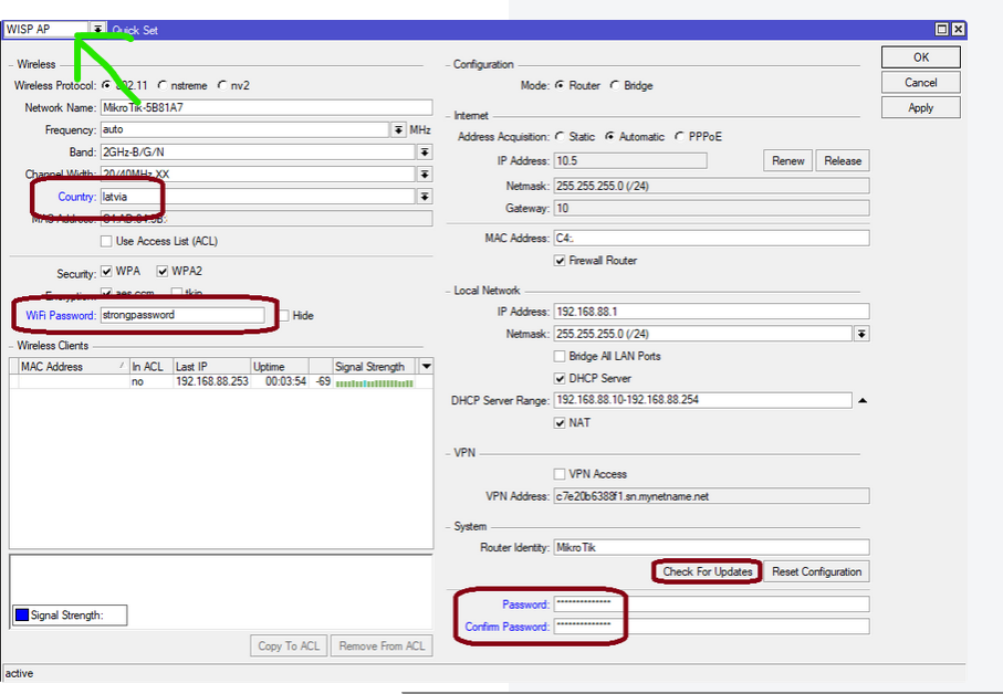

on the manual https://help.mikrotik.com/docs/display/UM/wAP+LR8+kit it says:
-In the “QuickSet” menu set up the following: Choose your country, to apply country regulation settings;
-Set up your wireless network password in the left field;
-Set up your router password in the bottom field;
But they are doing this on a WASP AP, shown in the image below. I dont want a AP, i need the device to work as a wifi client.
And why should i enter my router password? i dont know what this is intended for.
Like i sayd before, im confused.
