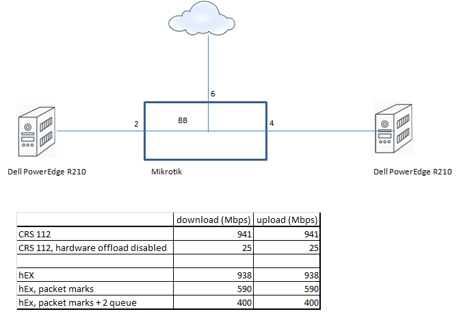

I’ve done a few measurements with the CRS112 and the hEx in a lab setting. See diagram below.
The ports of the Mikrotik were connected via a bridge and iperf3 measurements were run between two PowerEdge systems.
Without any mangling or queues both the CRS112 and hEx indicated about 940 Mbps.
With hardware offload disabled the CRS112 dropped to about 25 Mbps.
With only mangling active the hEx indicated 590 Mbps.
When queues were activated as well I measured about 400 Mbps.
