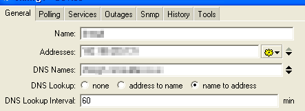

The dude will do a DNS lookup at set intervals and change the IP to match the returned result… I have not used it and the device should be down while the address does not match but it is there. Just put the FQDN in the DNS Names: field and set the lookup interval to a low value.

Ahh yes so that should work, just set the dns update time very low like 2 minutes and set the polling up on those devices to 2 minutes or more with 3 failures then you should always get the IP address and probes should stay up.
