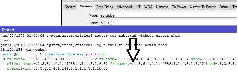

How to monitor frekvency in AP Bridge mode?
Hello. I need monitor frekvency in AP bridge mode?
OID in my picture dont work? Dude 3.6 dont show any value :frowning:
Any solution?

in 6.0rc7 it is possible to get the frequency value:
do /interface wireless print oid
for me the OID was:
.1.3.6.1.4.1.14988.1.1.1.3.1.7.4
it is dynamic and can change from AP to AP, so be careful and do not blindly copy it over
just by enabling basic SNMP configuration:
$ snmpget -c public -v 1 192.168.88.1 .1.3.6.1.4.1.14988.1.1.1.3.1.7.4
iso.3.6.1.4.1.14988.1.1.1.3.1.7.4 = INTEGER: 5300
It is posible add this OID for RouterOS 5.23? Thanks
And why don´t work OID in first picture. DUDE don´t show any value. But snmp walk works with this OID.
