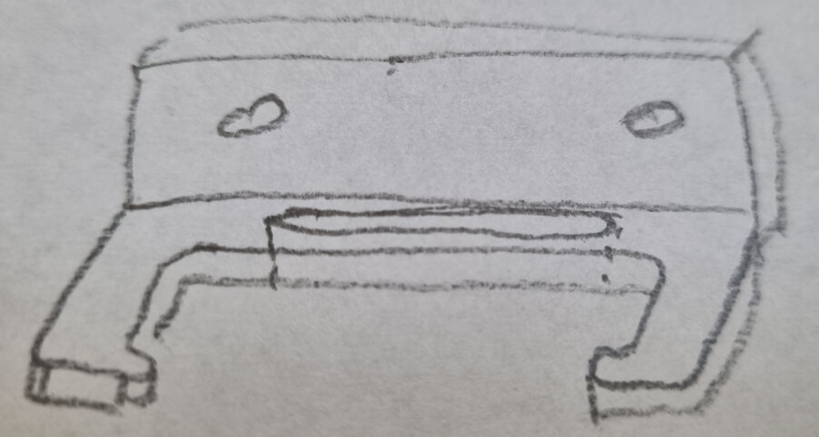

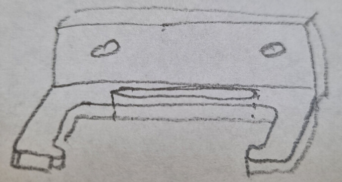

3D printer + some creativity: the indentation in bottom part of a device lets to make a hug that let to slide te MT into.
Example with long hole for cables

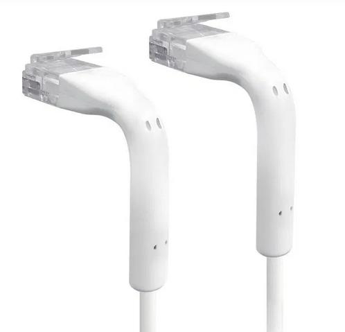

I have never come across such connectors, I have never seen them.
I'm talking about the connector Г .
or flex ones
That flex flat one is perfect to pass through windows frames if needed or under door leafs if needed.
Time before someone thinks they are earpieces and sticks them in their ears ... 3...2...1...
A normal connector on a flat (not round) cable can be bent at 90° needing very little space for the curve, the 90° RJ45 connector may be useful for some specific device that has the port in a recessed cavity covered by a lid, otherwise a normal flat cable fits everywhere.
But there are 90° converters/adpters like:
https://cdn.elecbee.com/catalog/Adapters/RJ45-Coupler-and-Adapter/RJ45-Adapter/90degree-angled-rj45-adapter-up-8p8c-utp-cat5e-male-to-female-lan-ethernet-network-extension-adaptor-4425-0.jpg
