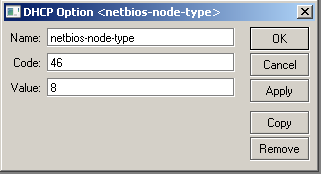

This works for me…
… at least on XP… Vista says it’s ‘Unknown’.
