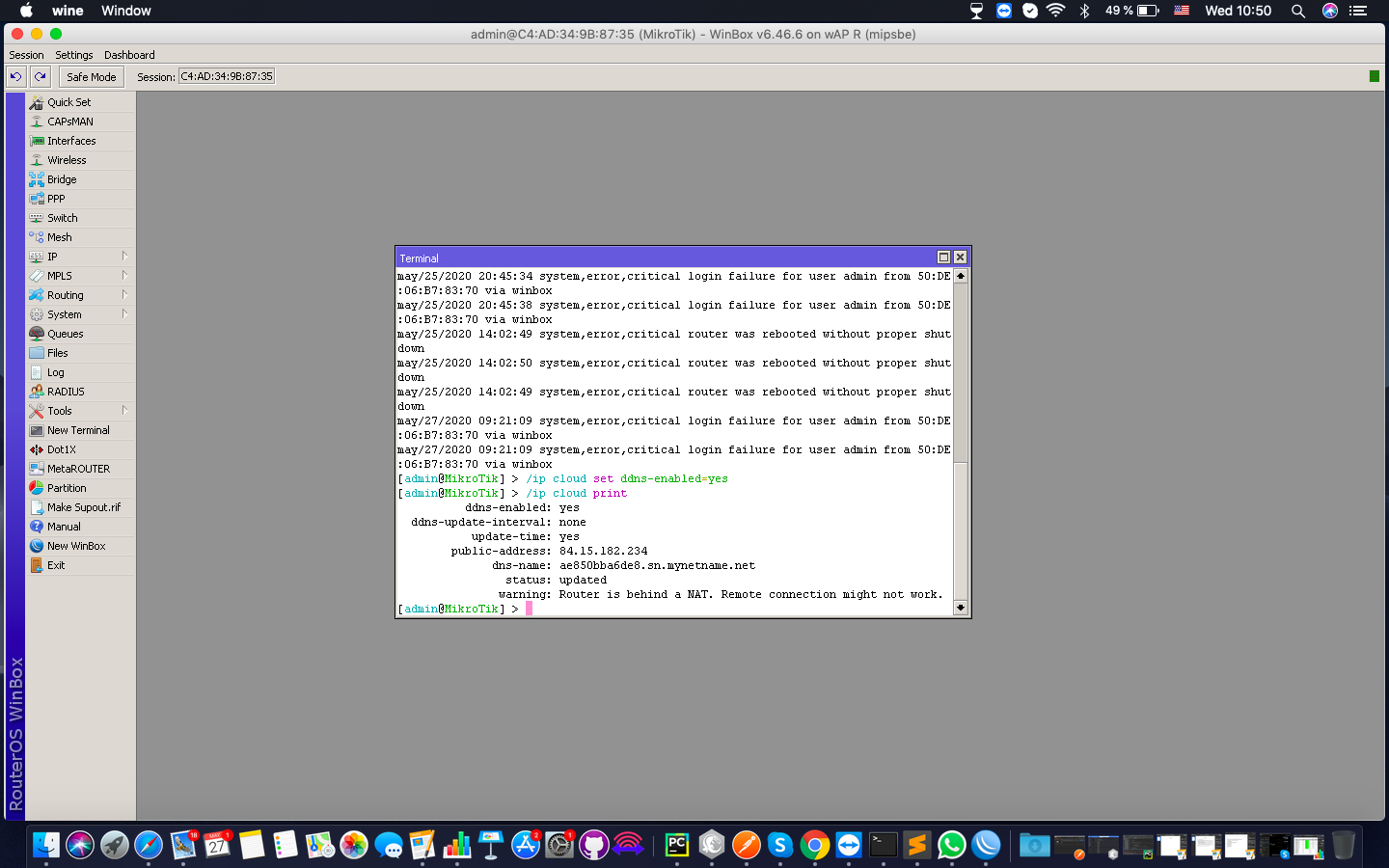

Sorry guys for interruption. But where I can set WAN parameters in order to connect to wAP LTE device from remote ?
Is your device already operational? Do you have access to WAN/Internet?
Do you mean admin access to your device from WAN? (a very bad idea in respect to security)
Or do you rather mean port forwarding?

No my device is not optional yet. I have access to WAN/Internet definitely:)).
What I’VE done I set up firewall rule: Tcp, dst port…
As well as DDNS was enabled.
My task is to reach a device by remote in secure way.
I will share a picture with you in order to make it more clear. Take a look please.
My plan is to use a router as primary connectivity for Base Station (IoT solution ). Router will retrieve internet from SIM card which one is inserted in the device.
If you have any further question ask I will try to explain you.
Looking forward a response from you
Kinds.

before we get into the practical method of accessing the router, either by VPN or port-forwarding, do you have a public accessible IP address? It does not seems to be the case by the look of it.
from your post: 84.15.182.234, belongs to ISP:Bite Lietuva which is an wireless ISP.
please first speak to your ISP and establish this IP address is assigned to you, before continue.
Right. He seems to be using the local IP in DDNS. “/ip cloud” has such an option, I read somewhere.
“use-local-address” → https://wiki.mikrotik.com/wiki/Manual:IP/Cloud
$ nslookup 84.15.182.234
234.182.15.84.in-addr.arpa name = IN-84-15-182-234.bitemobile.lt.
$ nslookup ae850bba6de8.sn.mynetname.net
Address: 10.1.84.70
indeed, the screen capture shows he is behind NAT and the last line gives the answer: “remote connection may not work”
looks like he’s got an private IP from the ISP, normal for mobile network.
No, “use-local-address” means to assign the local IP instead of the public IP to the DDNS record, ie. in DNS.
In that case the dns name can of course be used only in LAN, ie. behind the NAT border.
good to know. but in this case, even he assign local IP to DDNS record, he still won’t be able to access his wAP LTE remotely (from the internet)
the simple way to get this to work, is that you need to buy a public IP from the ISP
