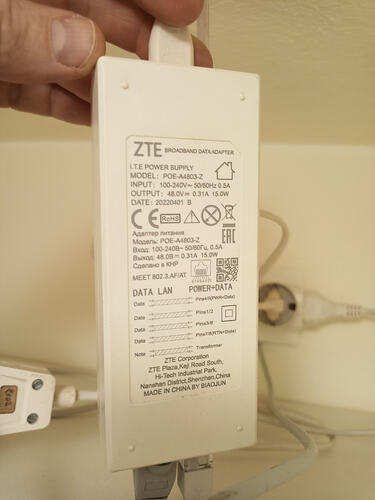

As of now I have an FWA Antenna powered with a power supply compatible with 802.3.AF/AT (see attached image) connected to a Fritz!Repeater that provides WiFi.

I’d also like to minimize the cables and power supplies: from some researches looks like that I can power the L009UiGS-RM using the existing ZTE adapter.
Can anyone confirm that at least theoretically this works?
And eventually how the connections would work?
Is it correct to connect the ZTE power supply to L009UiGS-RM’s eth1 and then the connect the FWA antenna to L009UiGS-RM’s eth8?
Finally I will connect the Fritz!Repeater to any of the free ports (eth2 > eth7).
Do you think this setup is going to work?
Thank you very much!
That power supply is designed (rightly) to power only the ZTE.
If you add more, it won't have enough power.
It might run for a while, then die.
You can also use just one power supply, but it must be powerful enough to power both (and the future SFP module, too...)

L009 can be powered using power adapter shown on your photograph. However you'd have to do some power budget calculation: PA is rated at 15W, L009 own consumption is "up to 8W", so only 7W would remain for FWA device. Is that enough (I somehow doubt it).
Another thing is that L009 supports only "passive" PoE out on ether8. It might work with FWA or might not (if FWA insists on 802.3 af/at power negotiations). Most devices don't and if PSE (PoE-out device) provides power at expected voltage, they will power-up even without power negotiations. But MT's implementation of passive PoE-out does include some (minimum) checks and an 802.3 af/at compliant device might fail them. In such case it might help if PoE-out was set to "forced on".
You would probably be able to do the "daisy chain" powering, but you'd have to source a more powerful 802.3 at/bt power adapter, capable of 30W (or more) power output.
