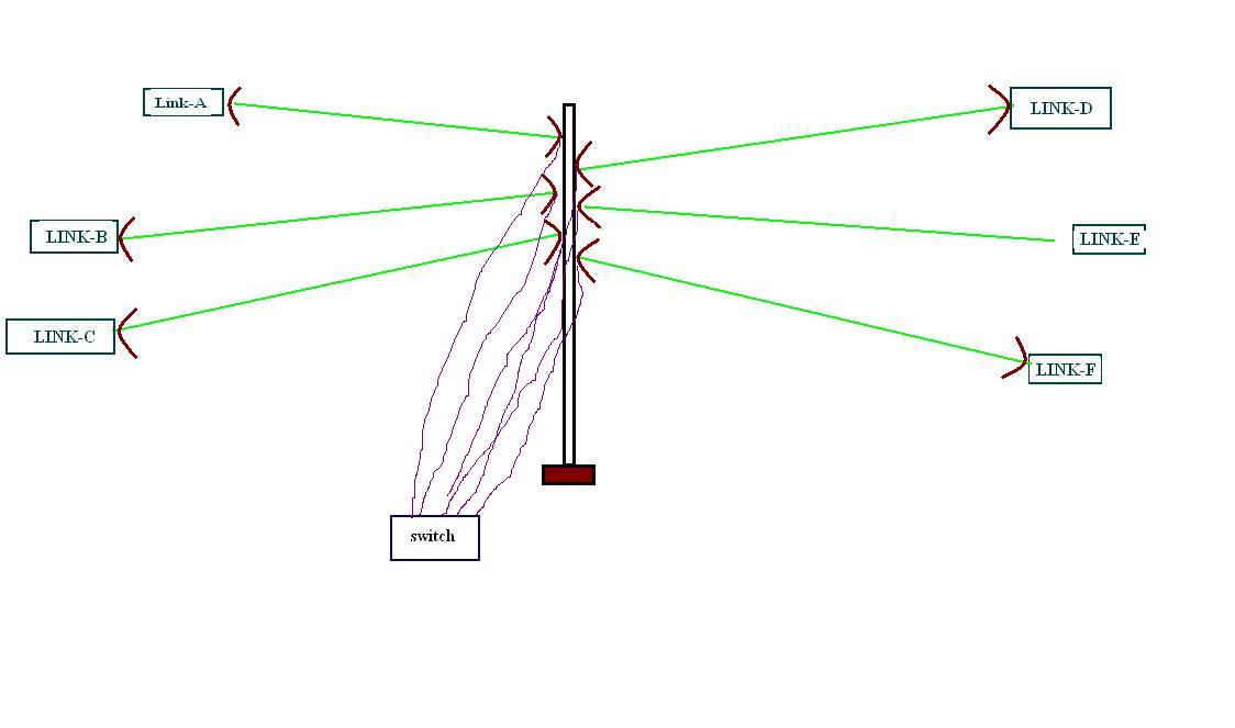

i have got 6-10 point to point transparent wireless link…
the summary of configuration is:
i create a bridge interface and wds interface and then add ether-1, wlan-1, and wds1 to brdige interface
in wireless setting i kept mode = bridge, wds= dynamic and in wds-1 interface i add the mac address of the other radio.
i keep similar settings on the second radio for point to point transparent link. i was using these kind of setup forlast3-4 years without any issue.
but when i start receiving RB with ROS 5.0 or above and configure a transparent link in above manner i faced problem, the ping to other point to point link start to break there are few replies and then request time out, but as soon as i shut down my new ptp link all links works fine again… but its happening with ROS 5.0 or above. is this is looping, how to prevent looping in the following scenario
note the Cat-5 of radio of every point to point link at my tower is inserted into a common switch which is non manageable.
Make sure you enable RSTP and static MAC address for all WDS bridges.
protocol-mode=rstp admin-mac=xx:xx:xx:xx:xx:xx auto-mac=no

Bridge MAC address is inherited from first (in order they were added) active bridge port. With static MAC address you can prevent MAC address jumping.
