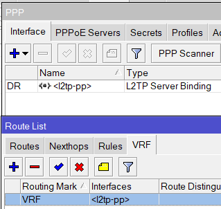

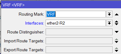

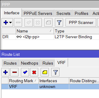

So if i put dynamic (ppp-server) interfaces into vrf.
Once that interface bounces, will disappeared from the VRF list, which is understandable, but it will pop up another interface (most of the time ether1)
See the folowing pictures, what is false here?

Even in your pictures it shows “unknown” and did not replace it with ethernet as you stated.
Of course if you open configuration window, winbox must have a known value and then, yes it will pop to the first valid. It is not just vrf, this behavior is everywhere where you add dynamic interfaces in static configuration.
Also the one of the picture showing interface as blue.
not sure what does it mean, but i got your point. Clear enough
Yes, blue is another indicator. Blue means that value is changed and changes are not saved/applied yet.
