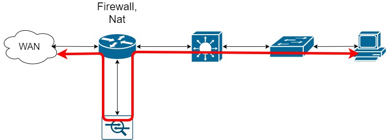

I want to impliment an IPS in our organization, which will scan all traffic from branches (VPN) and HQ goes throught border GWs for blocking malicous traffic in real time.
And now I have a problem. IPSs are not inline (for some reasons), they are connected to Mirkotik via separate ports. I maked redirection rule in mangle, set interfaces, which traffic I want to redirect to IPS and nothing happend, users can’t go to the Internet. When I make traceroute, I see that traffic goes normally to border router, then redirects to IPS, goes back to router and that’s all. In firewall rules I’ve set a rule with accept action to see, thats traffic comes back to router, but NAT rule counters is 0. All going normally when i turn on nat rule on IPS interface, but i don’t need it.

No any rules are present. Now I just test it all at test stand. Mikrotik’s config is empty at all. So, i’ve add traceroute how traffic goes without redirection to IPS and with redirection.
I saw at one forum, the discussion was in 2014 and one man said, that’s mikrotik can’t nat traffic, which redirected from mikrotik to other device and moves back to mikrotik for forwarding to isp throught NAT. Is it true?

You have another (free) interface on the IPS that you can cable to the Mikrotik ? So not “IPS-on-a-stick” but different interface?
Then configure another 172.16.4.x/30 subnet between them.

Still doesn’t work even if I maked separated link just with default route and separated link with internal subnets. Mikrotik still works how it was with single link… I’m sad :frowning:

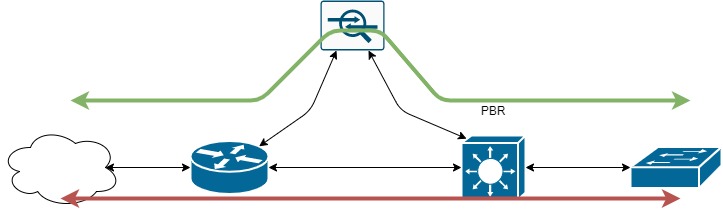

Now i will try another disign and use pbr on my L3 Cisco switch to separate internal LAN traffic (green) and guest (red) traffic.
Hope it will be ok… If not, we’ll buy pre-owned cisco routers.
