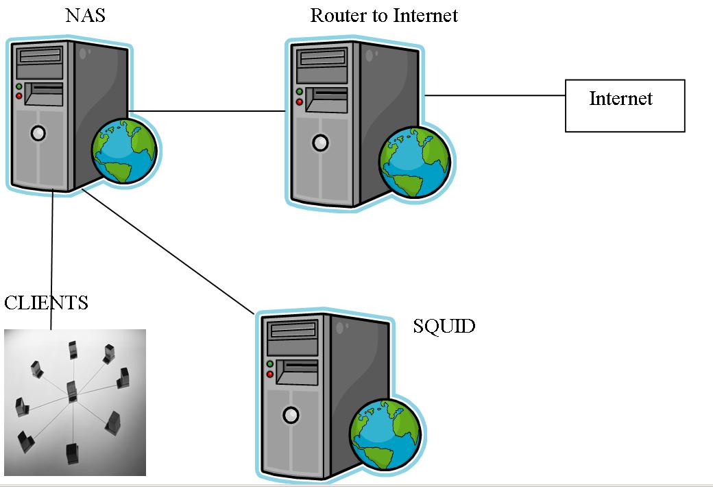

I have 2 ROS 2.9.51 PIII
1 For NAS Server, and the other is for NAT Server to Internet
Look at the picture, this is the topology.
My Squid Is in the same network with NAS (192.168.250.0/24 network)
My Clients (PPTP and PPPOE) get IP addresses from 172.16.0.0/12 network.
I just want to redirect the HTTP port from network 172.16.0.0/12 to 192.168.250.50 port 63333( Ssuid listens on this port)

are your clients, NAS and squid in different physical segments (different broadcast domains) or only different IP segments?
They are in different IP Segments,
so you need they be on different RouterOS interfaces (VLANs, for example)
Thanks Chupaka,
I have already done using 2 different ROS.
