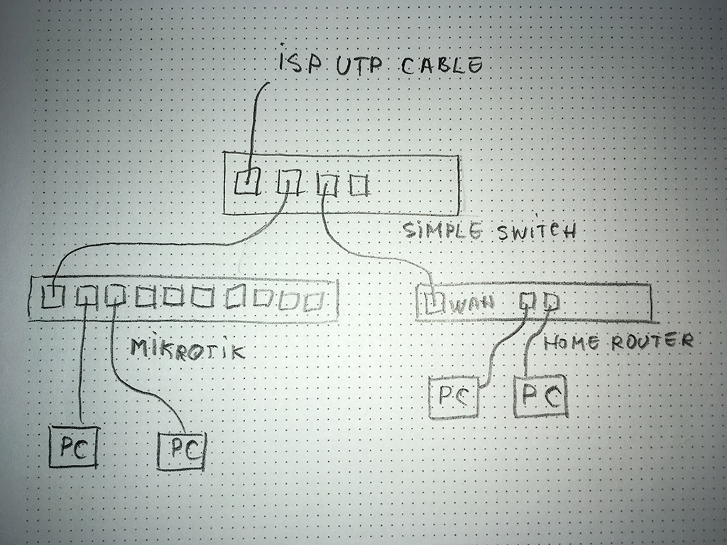

How to remove the static switch from this setup ?
I have the setup from the image, one utp cable from ISP, split by a static switch, one to Mikrotik and one to a home router.
I want to remove that static switch, but the setup to remain the same, so the home router will still have a direct line to ISP.
How can I do that in Mikrotik settings ? Now it has a bridge for all ports 2-10 and I think that prevents me from just plugging the home router to one of these ports.
The reason I want it just like before (like in image) is because the home router should make it’s own pppoe connection to ISP and I want it to be more stable and separated from the other Mikrotik routes.
If it is not something very simple I will just leave it as it is :slight_smile:

Home router will work as wifi too, I tried it as access point too but this particular (Netis) router caused some problems (slowing down network, ping timeouts, etc);
So I prefer to just use it separately, but it needs to get the main cable signal to/from ISP like it was in the image.
I will make some experiments unless someone knows the exact way to do it. Just because I would get it to work doesn’t mean I did it properly :slight_smile:

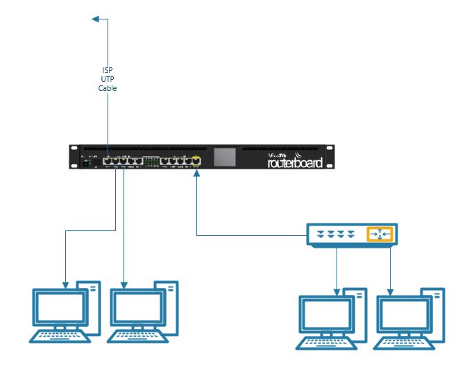

connect isp utp directly to Mikrotik ether1
connect your home router to etherXX (any open port)
create a new bridge
make ether1 and etherXX part of that bridge.
Done
You will also have to substitute the new bridge name in the WAN interface list, and anywhere else that ether1 appears.
For instance, if you ISP connection is a pppoe tunnel, in ist “interface=”, or in the interface of its dhcp-client if it is dhcp straight
on ether1…
Correct… hard to give the full answer when we dont have a config…
Let’s say you want to use port ether2 on your main mikrotik to connect home router. You need to create new bridge with ports ether1 and ether2 … and configure WAN interface on main mikrotik on the new bridge instead of ether1.
Steps would include:
  1. remove ether2 from current bridge
  2. create new bridge (let’s call it bridge-wan)
  3. remove ether2 from interface list LAN
  4. add ether2 and bridge-wan to interface list WAN
  5. add ether1 and ether2 to the new bridge, make sure you set hw=no on those two ports (this will allow full speed switching between LAN ports)
  6. move internet setup from ether1 to “interface” bridge-wan
  7. review firewall rules … both filter and NAT. If any of them refer to in-interface=ether1 or out-interface=ether1, change them to refer to in-interface**-list**=WAN or out-interface**-list**=WAN respectively
  8. plug home router to ether2, plug ISP ethernet cable to ether1
