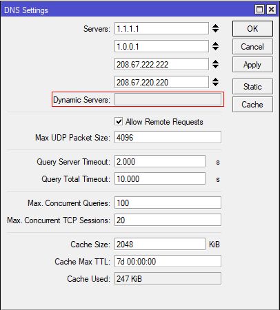

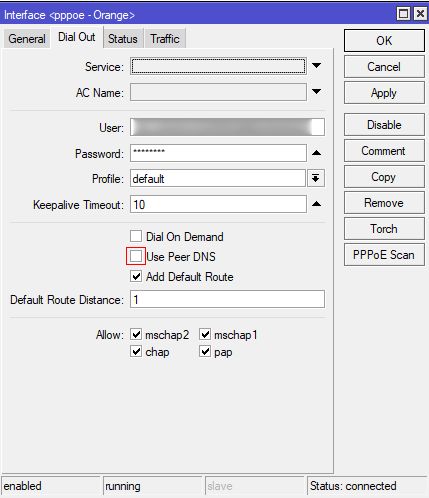

Have a look at my PPPoE configuration:
so I do not have dynamic servers DNS entry:
When I check the box “Use Peer DNS” it is on the list in a moment.
