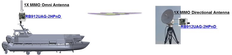

First of all please refer to PTP link configuration below;
May I ask how to replace above omnidirectional antenna with 4 x Sector Antennas as below based on Routerboard(RB912UAG-2HPnD)
by any idea or additional device such as 4xdiversity antenna switch ?

What do you plan to achieve, why do you need sector instead of omni? Normally you use sectors to make sure you only cover a narrow area OR you want to separate clients for better interference etc. Then you need as many wireless interfaces as sector antennas.
As you may understand our main application is a wireless control & monitoring between Ground or Mothership and boat(Manned or/and unmanned control such as USV).
We just want to expand the link distance when we need to control / monitor the USV(Unmanned Surface Vehicle) from Ground/Mothership control center as much longer distance as possible.
Normally we install and use omnidirectional MIMO antenna with low gain on the boat (USV), which has limited gain.
We can achieve much higher antenna gain if we instal 4 x sector antennas with 90degree beamwidth so that we can cover 360degree horizontal if we can configure those sector antennas with Router Board.
However we don’t know how to configure the 4 x sector antennas for 360degree coverage with space diversity effect.
So we are looking for any good solution / other idea based on router board(RB9122UAG-2HPnD) PTP link with regard to USV control / monitoring application for much longer distance link.
