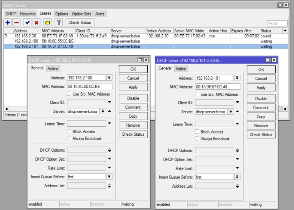

I did as they requested, inserting the MAC it allowed to reserve the IP, thank you
But now comes another question, did you reserve it? Does it have that same “wating” status reserved? Remembering that the two DVRs are already in the network, only they are fixed IP
If devices (DVR) are statically configured with IP addresses, then DHCP server will not see request for address from those devices. The status column refers to how DHCP server sees the status, not how devices are using IP addresses in question.
The whole point of the exercise above is to prevent DHCP server from assigning reserved IP address to some other device. Hence status of these leases will always be “waiting” … unless you configure DVRs to use DHCP auto-configuration.
Got it, thanks, but did I get to reserved?
Yes. As the screenshot shows … these two are on the list of leases, but don’t show a ‘D’ in the status column (‘D’ stands for Dynamic) … so they are static leases, reserved forever and won’t get re-used as dynamic lease for any random client.
