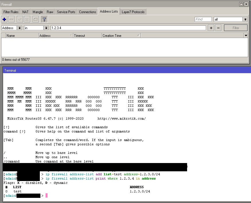

I tested your code below. The CLI code works great, and I can search that way. However, when I put the exact same info into the filter in the Winbox GUI under Address Lists, it fails to find anything. Is the GUI supposed to work just like the CLI?
The attached picture shows what I mean, I used your code to create and search for an address list, and I can find it via CLI but not via Window GUI filter.
You’ve solved my issue, since I can search using the CLI. Mostly now I’m wondering if I found a bug in the way the filter works in Winbox that I need to report.
I appreciate your assistance.
Looks like that. Two possible interpretations of the contains operator in Winbox come to my mind:
  • a regular expression matching of the column value interpreted as text, which on command line would look like address~“1.2.3”
  • a way to simplify the graphical representation of the constant in column expression, allowing to keep the column at the left side and the constant at the right side of the form
None of these works; however, since actually the contains and in operators work exactly the same way in Winbox (in your example, if you fill the constant field with 1.2.0.0/16, the 1.2.3.0/24 item is shown no matter whether you choose in or contains as the operator), I assume the “inverse in” was the designer’s idea, but the coder forgot to swap the roles of the operands.
So yes, your next step should be to raise a support ticket at https://help.mikrotik.com/servicedesk/servicedesk/ or by e-mail to support@mikrotik.com . You can refer to this forum topic.
Thank you, Sindy.
I’ve opened a support ticket bug notification.
Its not so much a bug as it is just a missing feature.
The filter list in winbox gui only allows the order of the command one way - set out by the way the fields are set out
i.e. “where address in 1.2.3.4”
vs the opposite way that you actually want
“where 1.2.3.4 in address”
So this is likely more a feature request to change how the GUI handles creating filter statements to apply to the shown list.
