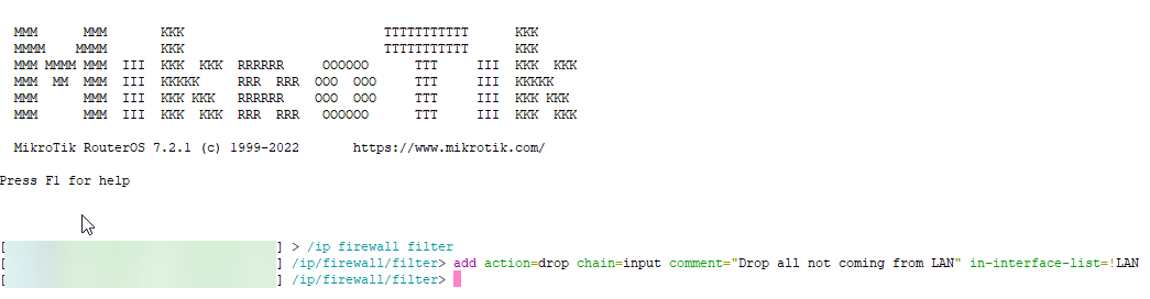

this I didnt add, because “expected end of command (line 1 column 68)”>
add action=drop chain=input comment=“Drop all not coming from LAN” in-interface-list=!LAN
in-interface-list=!LAN - here is some error, but friday is the day :slight_smile:
There is no problem with the command maybe you didn’t add ip/firewall/filter
