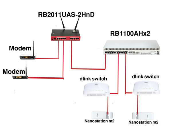

how to set configuration for two RBs. one for merge and second for sharing ?
hi all,
i have two routers, RB2011 for merge 2 links dsl, and RB1100 for sharing internet , and i have problem , that laptops connect to network but there is no service( no internet) , and show this error in the browser(DNS_PROBE_NO_INTERNET"), and there is no problem with mobile but i feel sometimes slow browsing in mobile , i don’t know if that cause of wrong setting or in wrong connect ?
this is the configuration for RB2011

and this is the configuration for RB1100
# may/23/2016 19:47:11 by RouterOS 6.35.2

and this is design for my network
hello
test dns in rb1100
set max-udp-packet-size=512 servers=8.8.8.8,8.8.4.4
thanks friend, i will test it
didn’t solve the problem , i noticed that when i work with only RB2011(merge and sharing), and when i go to bridge and enable settings (use ip firewall )and (use ip firewall for vlan) , it comes the problem , and when i disable the settings there is no problem. so i tried to make it when i make the RB2011 for merge and RB110 for sharing ,and disable these settings in RB110, but nothing , still with this problem .
is there anyone can help me ?
not solved .. i don’t know if the problem from switch or rb . but when i connect nanostaion direct to ether6 , laptop connect without problem
no one can help me plz ?
