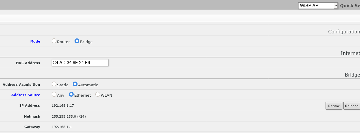

I have a MikroTik “cAP ac” device behind my main router. Main router hosts DHCP server and provides NAT access to internet. I would like to use MikroTik as an Access Point for wireless devices, and let those devices obtain IP addresses from dhcp server of the main router (there should be no nat and no dhcp server on MikroTik). Is the Bridge Mode (see screenshot below) a proper way to achieve this configuration?
The problem is that once i set MikroTik to the Bridge Mode, MikroTik does not obtain an IP address for its own Webfig server and becomes completely unmanageable. How do i fix Webfig?

Solution for the problem: do not specify “Address source: Ethernet” (as on screenshot in first message of the topic), instead specify “Address source: Any”. It results in dhcp-client successfully obtaining IP lease on the main router (and, as a consequence, fixes access to Webfig). Although i don’t understand why does this solution work: connection to the main router is wired, not wireless!
